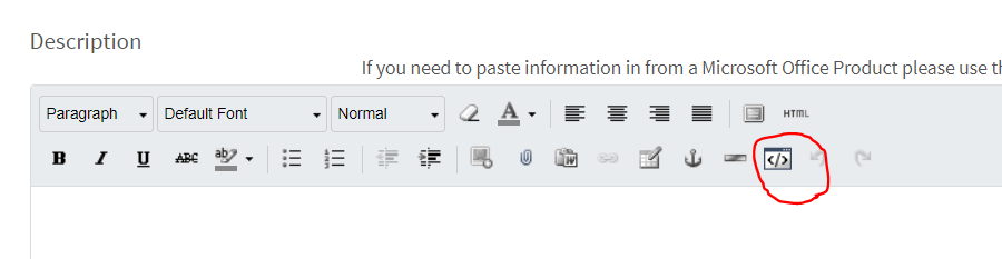

  • On a different note, if you insert a code snippet in your post, always paste it using the “Syntax Highlighter” option. That makes the code easier to read.
