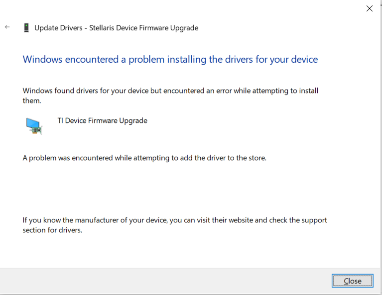

I want to run the bootloader project. I am using TMS320F28069 controller.
I am using mac machine with windows 10 home version as virtual machine to run the dfu_prog.exe .

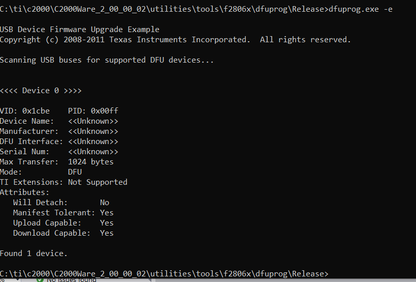

 When I run the code , Device Manager shows USB connected in DFU mode. Then Irun the dfuprog.exe(which is available on control suite) through command prompt with the option –e to show the  list of DFU device connected to  PC but dfuprog.exe gives the error says that the DFU device is not connected.
I tried installing the device drivers from this post , but dint help.
https://e2e.ti.com/support/microcontrollers/c2000/f/171/t/325729?USB-bootloader-along-with-dfuprog-exe
. When I try to link the new drivers from the above link windows is not letting me update the driver and shows the following error
Could you please point out where could be the possible error and help me get this project working.
