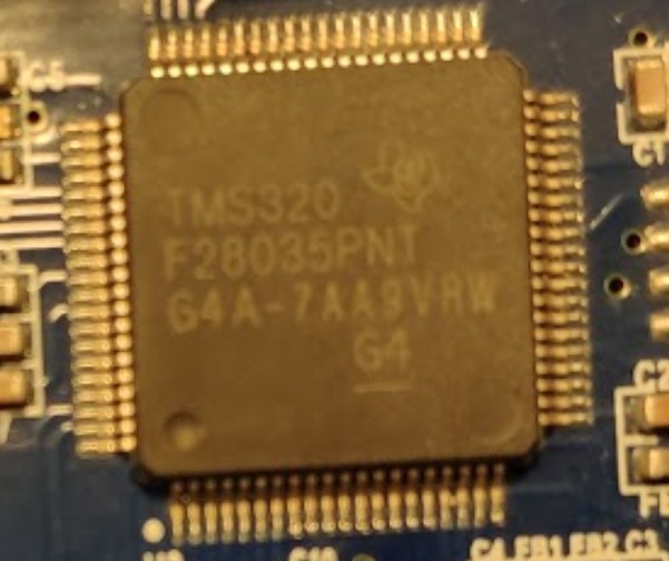

We have a product that has been working with F28035 for 4 years. We encountered a problem in our last production. CANBUS works for a certain period of time in all products in the last production and then falls into error and the bus is turned off (CANGIF0 = 0x00002700). After searching for the cause of the problem for a while, we replaced the F28035 with the ones that were used in the previous production.

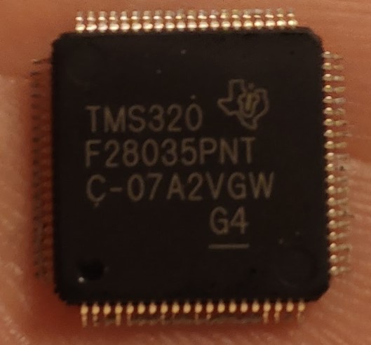

We saw that there was no problem on the same card as the F28035s we used in the previous production.The F28035s used in the new production look like revision 0 and the F28035s used in the old production look as revision A. You can find the pictures below.
Used in new production (CANBUS problem experienced)
Used in old production:
Do you have any suggestions for the problem?
