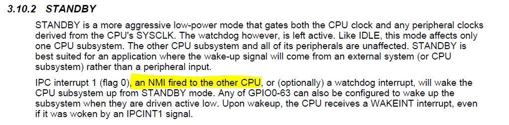

  • Alain,
    I was able to check this and your observation is correct but this is expected behavior as per TRM. Following is snapshot from TRM.
    In this case NMI on CPU1 is waking up CPU2 from standby. Hope this is clear.
    Vivek Singh
