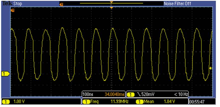

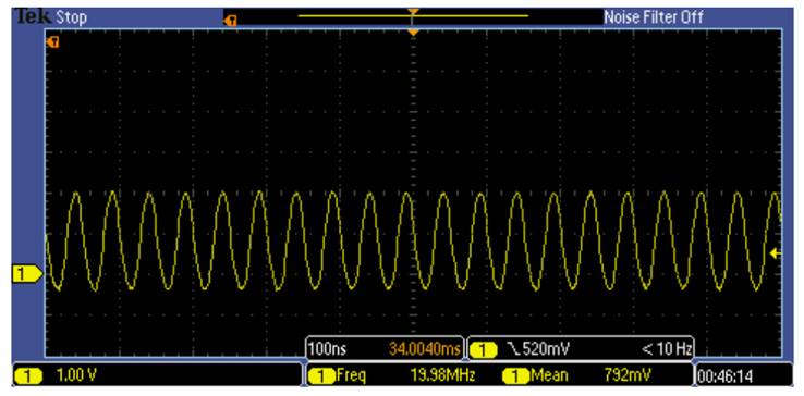

I checked the crystal oscillator signal at X2 and it seems to be good:

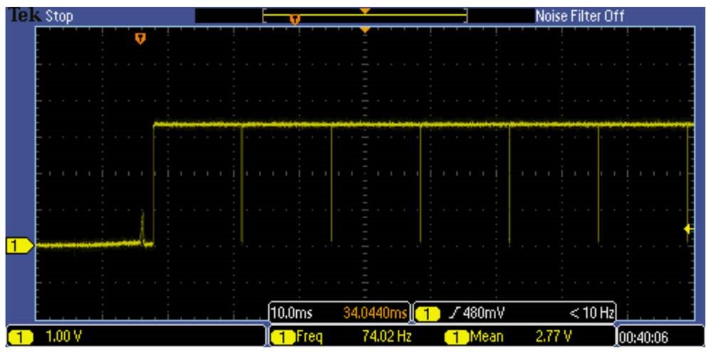

I have my suspicious on the reset signal XRS. I have it pulled up by 10k resistor to 3.3V with 1nF capacitor so it should be at high state but I see some internal resets on the XRS by the micro. It is at about 74kHz frequency with duration about 50us see below this is the power up XRS signal:
Why I see the internal reset any idea?

    The pulsing signal on the XRSn pin is indication that the internal WatchDog circuit is firing since it is not serviced by the FW(or lack of FW) that is on the device when it comes out of reset.
    We have an app note that documents common JTAG connection problems and how to solve them here: http://www.ti.com/lit/spracf0
    If possible I would also put the device in Wait Boot Mode, which will prevent it from executing code (and potentially locking and terminating the JTAG connection) as well as the WatchDog toggling XRSn.  The Wait Boot mode setting can be found in the datasheet here: http://www.ti.com/document-viewer/TMS320F28035/datasheet/boot-rom-litsprs230-0453#litSPRS230-0453

    1) I think I know what is my problem but would like to confirm it. I have an external watchdog connected to the XRS rest pin and I think it was not deactivated when I was erasing the Flash by CCS and XDS510 debugger. This means the XRS pin was pulled down by the external watchdog circuit when erasing the micro flash. Can this effect in permanently locking the microcontroller by setting zeros or random password in PWL of CSM?
     2) It looks that in the locked board even after setting the wait mode by external pull up/down resistors I still see the XRS toggled by the internal watchdog. How it is possible? Do you think that something else is still triggering the internal watchdog (for example brownout even if the micro is in the wait mode?

    1)I agree that this could have caused unexpected outcomes when programming the flash, and ultimately locking the device.  While the TRSTn signal will allow for the core to be kept out of reset, the physical XRSn signal goes to alot of other logic that TRSTn would not be able to bypass like the core.
    2)I looked at the source code for the BROM here C:\ti\c2000\C2000Ware_2_00_00_02\libraries\boot_rom\f2803x\v1_0\rom_sources\source and while Wait Boot will loop outside of a secure zone(which should allow the emulator to connect) the WatchDog is left on.  I was incorrect in my previous statement on this point.  However, this shouldn't keep the user from connecting through JTAG, only accesses into a secure zone can do that, and this cannot happen in this mode.
    Customer should be able to connect, and then looking at the CSM password locations in a memory window confirm that the device is locked.
