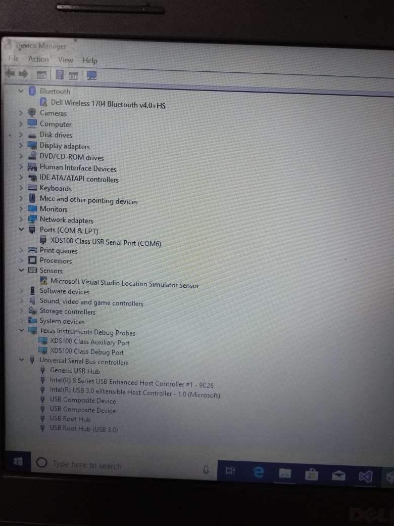

  • Hi  Harshmeet,
    You would see an unrecognized driver after connection. You need to install the driver provided in the same folder.
    How to install driver? Is there any procedure can you please provide me?
    Here i have attached a screenshot of my windows device manager.
  • Varada,
    You need to right click and go to install drivers.
    Choose the path where the windows driver is present in the flash programmer.
    Please make sure you use the latest C2000 Version.
    Harshmeet
    Here is the path of windows driver.
    C:\Users\admin\Downloads\ethercat\C2000Ware_2_00_00_02\utilities\flash_programmers\usb_flash_programmer\windows_driver
    Inside that F28x7x_USB_Boot_Loader is available. I did right click and install. Later one popup came as Operation completed successfully.
    But i didnt find any "TMS320F28x7x USB Boot Loader" under "Other devices" in device manager and not even unrecognised devices .
    thanks.
