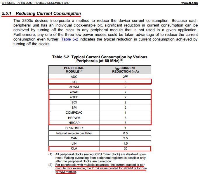

As 2803x datasheet described below, significant reduction in current consumption can be achieved by turning off the clock to any peripheral module that is not used in a given application.
I turn off the clock to peripheral module like I2C, eCAP, eQEP, SCI, SPI, COMP/DAC, HRPWM, HRCAP and CLA, according to table 5-2, about 45mA current consumption can be reduced, but there is no current  consumption difference between disabling those peripheral module clock and enabling those peripheral module clock, both the current are about 112mA. Following are the codes that I turn off the clock to those peripheral module.  So what's wrong?
