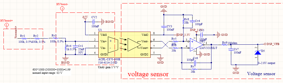

Here is my circuit sampling boost output voltage and feed to ADC.
I plan to add a ferrite bead in series with Rv9 to help filter EMI.
Question:
1. Is there any problem with my circuit design?
2. What else can I do to filter EMI?
Any suggestion will help!
Thank you!

    I apologize for the lateness from our side.  Here are some thoughts I have:
    1)Is it possible to convert the ADC input with resonant converter idle, to verify what component of the code spread is coming from the EMI?  I want to make sure the behaivor of the ideal state is normal
    2)Typically op-amps behave non-ideally with large capacitive loads, and to counter-act this a series resistor is recommended to help stabilize the output.  I see you have done this with a 100ohm resistor.  Looking at the resistances on the inputs, which are 20k, we might try a resistor of the same order on the output for matching reasons.
    3)Location of passives: for the final decoupling cap at the ADC input placing this component as close as possible to the physical pin will be best in terms of EMI immunity.  Not sure of your layout locations, etc.  Given this ADC design I would also place the same importance on the 2.2uF caps on ADCREFP/REFM pins as well as the RESEXT resistor.  The connection of the ADCLO pin needs to be as short/direct to the ground plane as well.

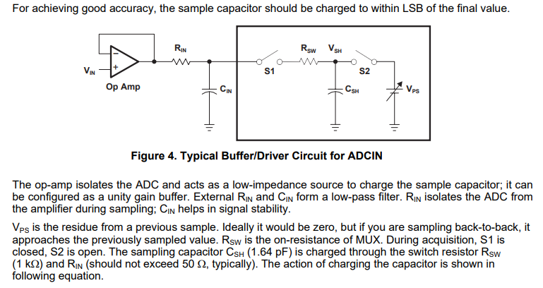

    For the second point, I look through an application report SPRAAP6A. On page 6, I see a suggestion that the input resistance should <50ohm. What do you think?

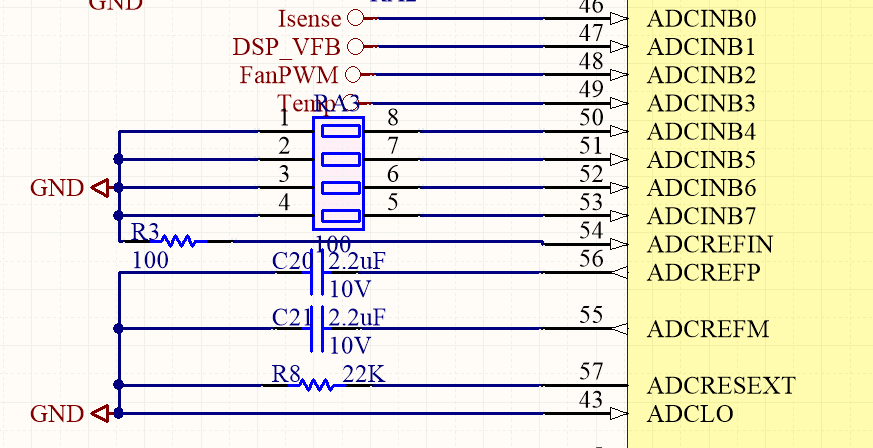

    For the third suggestion, let me show you my DSP sch ADC part.
    Capacitors and resistors are as close as possible to the corresponding pins. Is the design good?
    Xiaoming

  • Xiaoming,
    Your post with the passives on the ADC is good in terms of meeting the DS requirement, but I would also look at the layout and make sure the passives as as close to the device as possible.  Any extra wire trace between the passive and the pin will gradually couple in more noise from the system.
    For the op-amp, the last paragraph is referring to the inside of the chip/design, there isn't anything you can do about that circuit other than know the values(which we provide in the DS).
    For the external passives on the output of the op-amp, these would need to satisfy the RC equation for charging the S/H cap inside the device as well as meet any specs the op-amp has for stability.

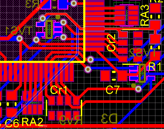

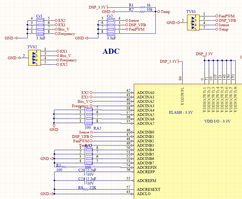

    Here are schematic and PCB design of ADC part of DSP28335.
    DSP and boost converter are on separate boards so I use jumper wires for signal connection. Opamp is on boost board. I am afraid the jumper wires are absorbing EMI.

  • The jumpers could be acting as an antennae, certainly the shorter the better; and if you can run a ground wire in the bundle it may help.
    ACQ_PS register controls the amount of time the S/H cap inside the MCU is allowed to sample the external signal.  So, for example, if you had a larger resistive load on the ADC input, you could use an larger ACQ_PS value to allow the internal S/H cap more time to charge/settle.
    You could try larger values to see if it might help average out the EMI you are seeing as well; additionally you could move your sample trigger to see if the EMI event could be avoided altogether.
