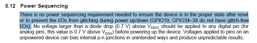

  • Wayne,
    please see the following excerpt from the Datasheet.
    For the default value of the Pull up resistor please look at the GPxPUD register's default value, 0= active 1= inactive on startup.
    To keep the GPIO in a known state you should add a pull-down resistor externally to the device. Ideally you will choose a GPIO without the pull up enabled by default, but the internal pull up is weak and can be overpowered by an external resistor. 10K ohms works for many applications for noisy applications 2.2K is recommended, but you will need to evaluate your system and determine the best value.
    Cody
