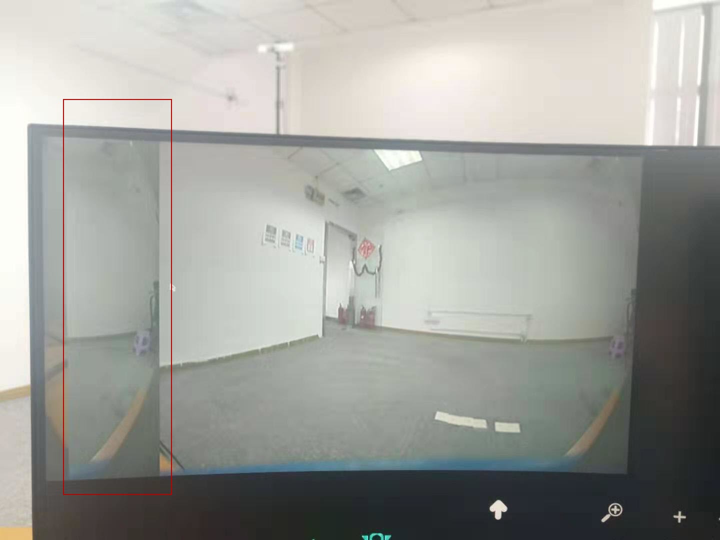

Hello, this is the image of the camera 913 through 954 on the monitor.Note that the red area of the image is a repeated overlay of the entire image to the right.The following is my configuration initialization script, mainly equipped with 954, camera 913 power on normal work.Why are there duplicate images?

    Please allow me some time to review these settings and get back with a response.
    Can you provide some more information about your setup? I see that you are using 2-lane CSI mode and also the CSI replicate output.
    Have you tried to use the pattern generator functionality to check this issue is present/not present?
    I would suggest the following initial debug steps:
    1. Enable pattern generator on 954 and observe the video output.
    2. Verify HSYNC/VSYNC coming from the sensor
    In addition, can you check the frame valid and line valid coming into the part? You can do this by configuring GPIOs on the 954 as indicated in the datasheet section 7.4.13.2
