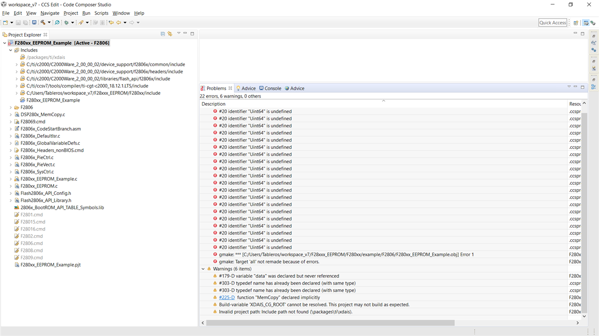

I have followed this procedure http://www.ti.com/lit/an/sprab69/sprab69.pdf to use the EEPROM Emulation, but unfortunately I have not run it yet cause some situations:
1.- The EEPROM example, at sprab69.pdf,  is compiled in the Code Composer 3.3 or so, I did the legacy import and  it get stucked in this code line (178) from this file (F280xx_EEPROM.c). The Code Composer sends me a message  "F28X_Prog.c is not found".
		// Program Bank Status to current bank
		Status = Flash_Program(Bank_Pointer,Bank_Status,Length,&ProgStatus);

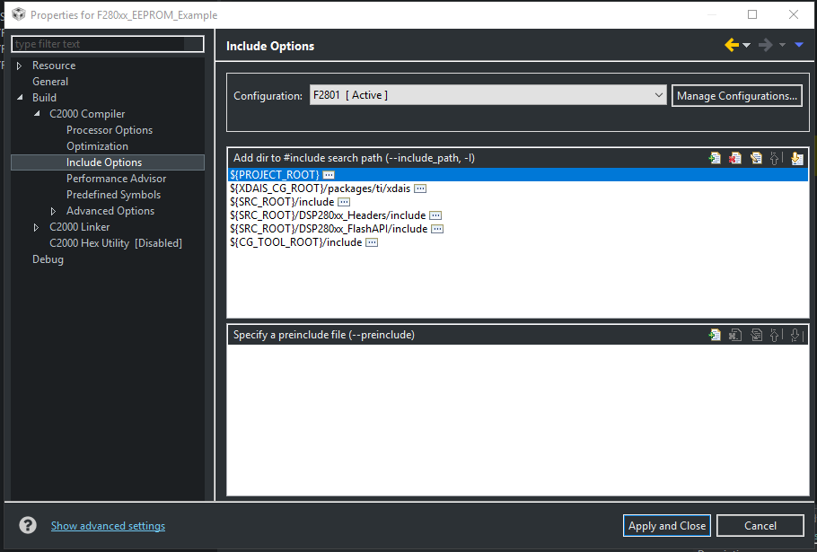

2.- ThenI realized that in the Example_2806xFlashProgramming, from ControlSuite, there is a file. (2806x_BootROM_API_TABLE_Symbols .lib) and it is different, or I think it could be, than the file in spra69 (Flash2806_API_V302.lib)
So I linked the Flash2806x_API_Config.h, the Flash2806x_API_Library.h and the 2806x_BootROM_API_TABLE_Symbols.lib in the spra69 project replacing the old ones and modifying the F280xx_EEPROM.h.
3.It run but now Code Composer sends this message (No source available for "0x3ff4fa")  in the same line code (178) in the same file (F280xx_EEPROM.c)
So right now I'm stucked and I think you can please help to run this EEPROM Emulation F28069 to use it in my application
Regards!
Mike

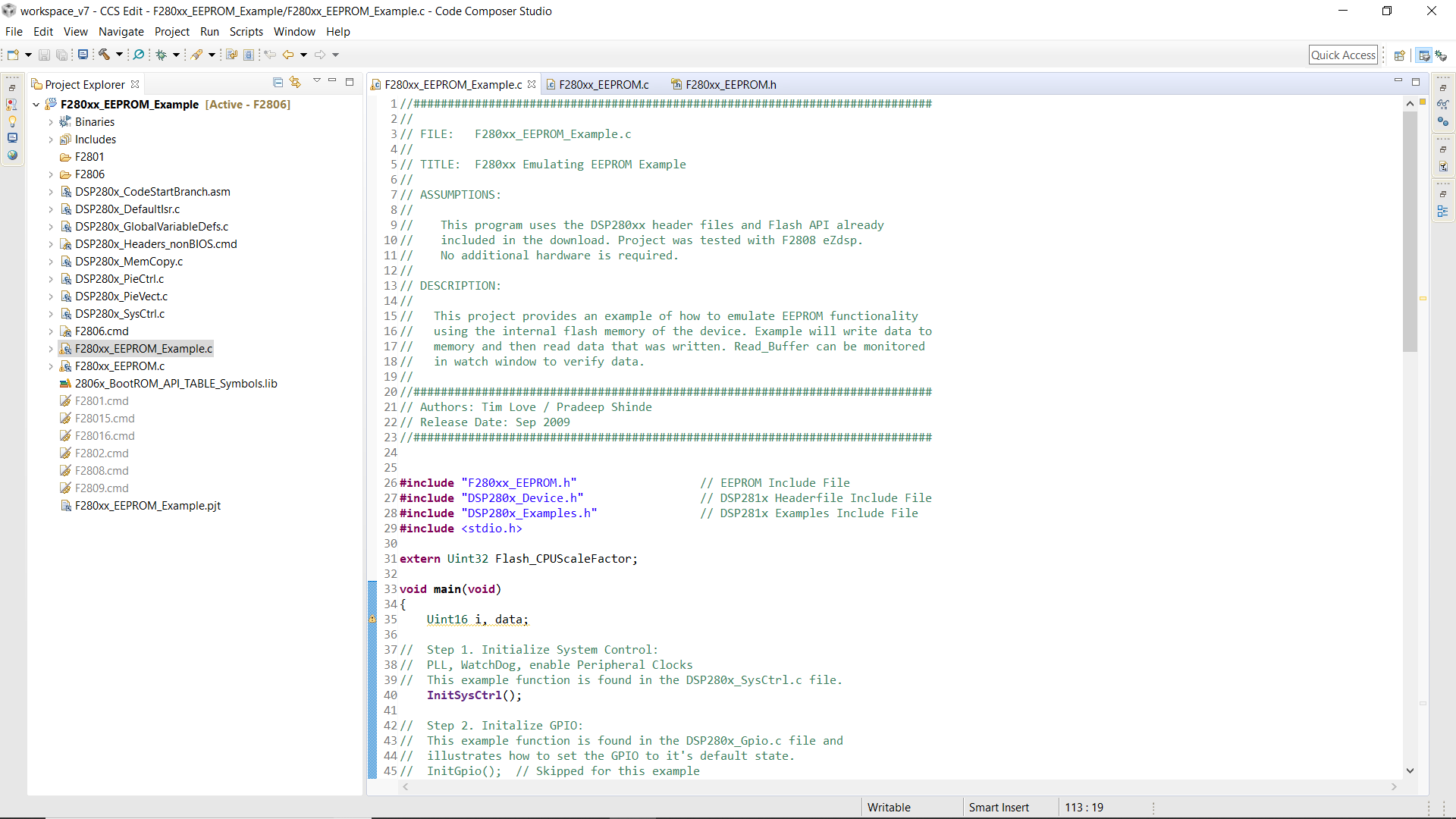

  • Hi Mike,
    As I mentioned this software and documentation is not meant for this device. A decent amount of porting will have to be done by you to get it to work.
    I will take a look at your modified F280xx_EEPROM.c and .h files if you attach them here.
    Kevin
  • Hi Kevin
    Sorry for Late reply, I took my hollidays.
    Here are the F280xx_EEPROM.c and the F280xx_EEPROM.h, The code lines I modified are marked.
    Thanks. Hoping we can get running this thing together.
    Mike

  • The lib file that is in ControlSuite (2806x_BootROM_API_TABLE_Symbols.lib)  it's already installed in the same root of the F28XX_EEPROM libs. I mean, I replace the old lib file for this new one.
    Also the Flash2806x_API_Config.h, Flash2806x_API_Library.h were installed to reaplce the old ones.
    Hoping to use this EEPROM emulation in TMS320F28069M or LAUNCLXL-F28069M!

  • Kevin
    Attached you will find the .c file and here it is the screenshoot.

  • Hi Mike,
    Looking at your project workspace you have a lot of files that are not for the F2806x device. You will need to go through and replace these with the correct files that match your device. Most, if not all, of these files can be found within C2000ware.
    For example, 'DSP280x_GlobalVariableDefs.c' should be replaced with 'F2806x_GlobalVariableDefs.c' which is at the below directory in C2000ware:
    C:\ti\c2000\C2000Ware_2_00_00_02\device_support\f2806x\headers\source
    You will need to update the 'Include Options' of your project to the F2806x files in c2000ware.
    For example changing '${SRC_ROOT}/DSP280xx_Headers/include' to the C2000ware directory 'C:\ti\c2000\C2000Ware_2_00_00_02\device_support\f2806x\headers\include'
    Do that for all includes listed.
    You will also need to update the includes (shown below) at the top of your 'F280xx_EEPROM_Example.c' file to match these newly included files:
    #include "F280xx_EEPROM.h"					// EEPROM Include File
    #include "DSP280x_Device.h"     			// DSP281x Headerfile Include File
    #include "DSP280x_Examples.h"   			// DSP281x Examples Include File
    Kevin
  • Hi Kevin
    I got some problems doing what you said, I think I' missing something
    Here it is the screenshoot
  • Mike,
    You can usually double click the error to find the line of code that is causing the issue. Where are these Uint64 types being defined and what for?
    Think the below typedef can be used if 64-bit unsigned ints are really necessary:
    typedef unsigned long long   Uint64;
    Kevin
