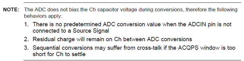

I have some questions about the behavior of Ch capacitor during for example SOC0 to SOC1 conversion process.
1. The switch is closed during S/H window, and the Ch will be charged by Cp and Cs capacitors. My question is that what's the behavior from the end of S0C0 S/H window to the beginning of SOC1 S/H window. Will Ch discharges completely, why or why not? How to make sure the next sampling is correct?
2. Is F2802x ADC sampling process same with F28004x and F2837xd(12-bit mode), and could we refer their computational formulas for F2802x to calculate the S+H duration?
Thanks!
-Rayna
    This note was added to the TRM to clarify that the Ch capacitor retains its residual charge between conversions.  There is no charging or discharging.
    The reason for this is that a properly matched ACQPS window will not require any preconditioning of the Ch capacitor, and the addition of Ch preconditioning circuitry will add complexity and introduce another point of failure.

    Does that mean the following steps, during the ADC conversions,
    1. When in SOC0 S/H window, the switch is closed, then Cp & Cs charge or discharge Ch capacitor, which depending the source level. Finally, the Ch voltage value which at the end of S/H window will be stored in ADCResult register.
    2. Between conversions, the switch is opened, the Ch retains its residual charge.
    Hope you could correct me, if any mistake.
    Thanks!/Rayna
  • Rayna,
    Yes, you are correct.  If Cs is small, then Ch is charged primarily by the source signal itself.
    -Tommy

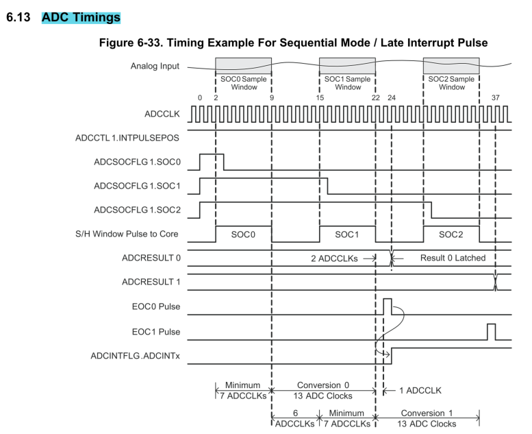

  • Hi Tommy:
         I am the user for this questions,I uploaded a word to help you see which of the two situations is right,left or right?Adc优先等级采样顺序梳理.docx
  • user1745435,
    Generally, your right-side scenario applies.  For sequential sampling, the ADC state machine will not separate the S/H and Conversion stages.
    However, for simultaneous sampling, the ADC state machine will separate the B-channel S/H from the Conversion in order to sample the A and B channels at the same time:
    The above simultaneous sampling behavior will carry over to sequential sampling as a non-functional side effect like this:
    The order of SOC processing when multiple triggers are received is determined by the SOC priority settings as described in the TRM.
    -Tommy

           Question 1: The second figure is not very clear. What sampling sequence and configuration is it? Can you describe it in detail?
           Question 2: If this Ch capacitor is charged very high by INA with high priority level in the second case of figure on the right side of word provided by me, does it mean that the input voltage of INB with low priority level in the next channel is lower than that of Ch, and Ch will form discharge operation to ensure that the sampling voltage is the input voltage?
  • Hi,Tommy:
             If the second problem exists, is there a good solution??
    The second scenario that I attached was with Sequential Sampling and Overlap modes where the ADC_A0 trigger is received before the ADC_B0 trigger.
    When a sequential sampling trigger is received, the triggered channel and its paired simultaneous channel will both close their S/H switches simultaneously.  So if only A0 receives a trigger, the Ch for both A0 and B0 will charge at the same time.  The A0 Ch is converted, but the B0 Ch is not converted because it is not triggered.
    If B0 is triggered while the A0 SOC is active, the B0 Ch will sample again just prior to B0 conversion.  This is what is shown in the example.
    I think the short answer is yes.  The Ch capacitor is not biased or conditioned between ADC conversions so there will be carryover charge from the previous conversion.  The ADC was designed with the assumption that the input signal will be properly conditioned such that it can charge (or discharge) the Ch capacitor within acceptable accuracy levels within the configured ACQPS window.
    For high bandwidth sampling, a fast buffer can be used to rapidly settle the Ch voltage.  For low bandwidth sampling, a large capacitor can be placed on the ADC input pin for charge sharing.  The ACQPS setting can be adjusted to accommodate different signal characteristics.
