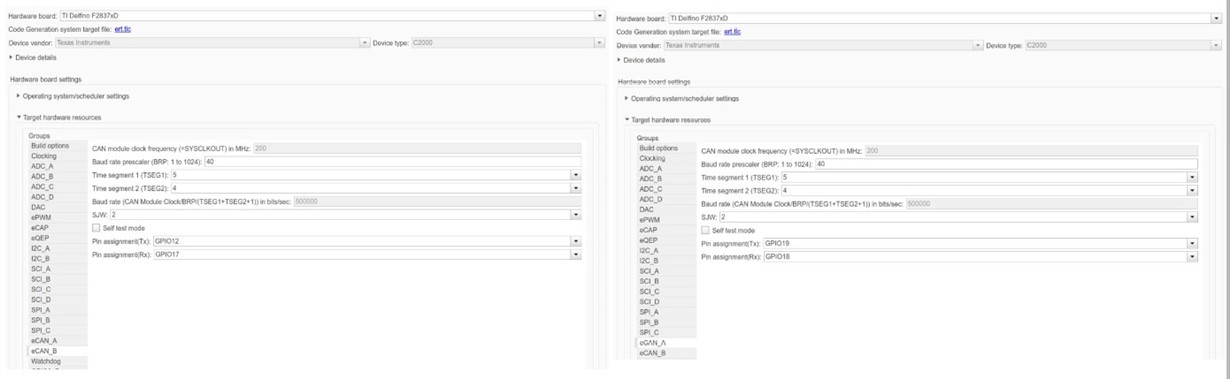

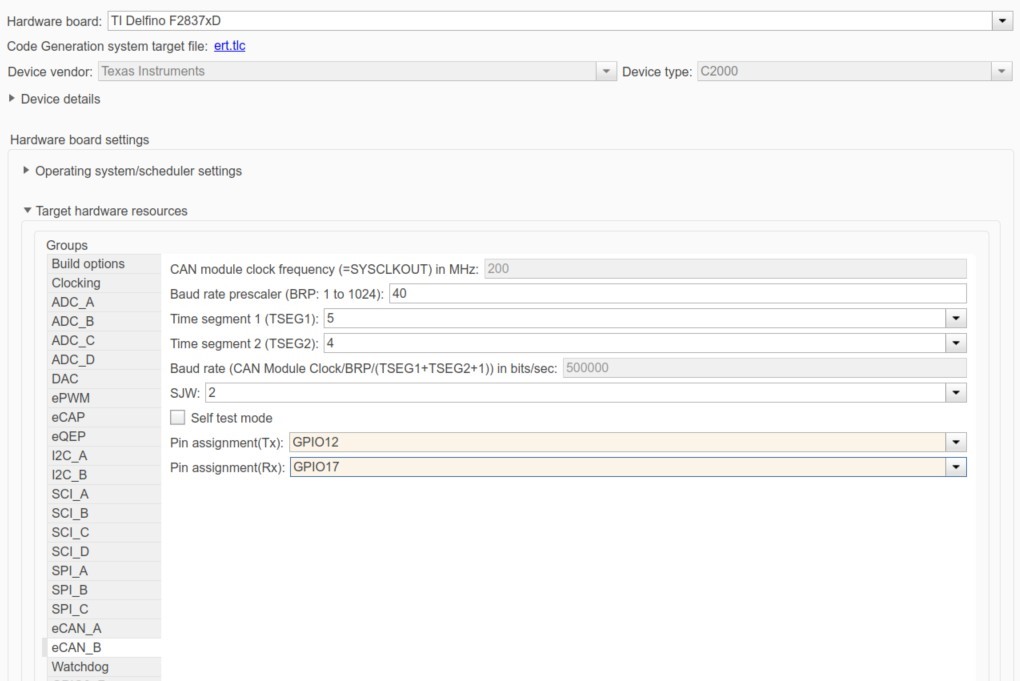

I can use CanBus on the development board J12.(set GPIO 12 17 in eCAN_B) Baud rate is 500kbps.
But I can not use eCAN_A.(set  GPIO 31 30) Baud rate is 500kbps.

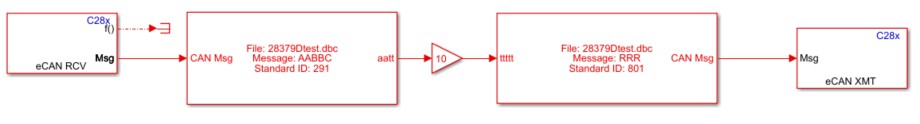

And this is my Simulink block.
Does anyone have a solution? Thank you.

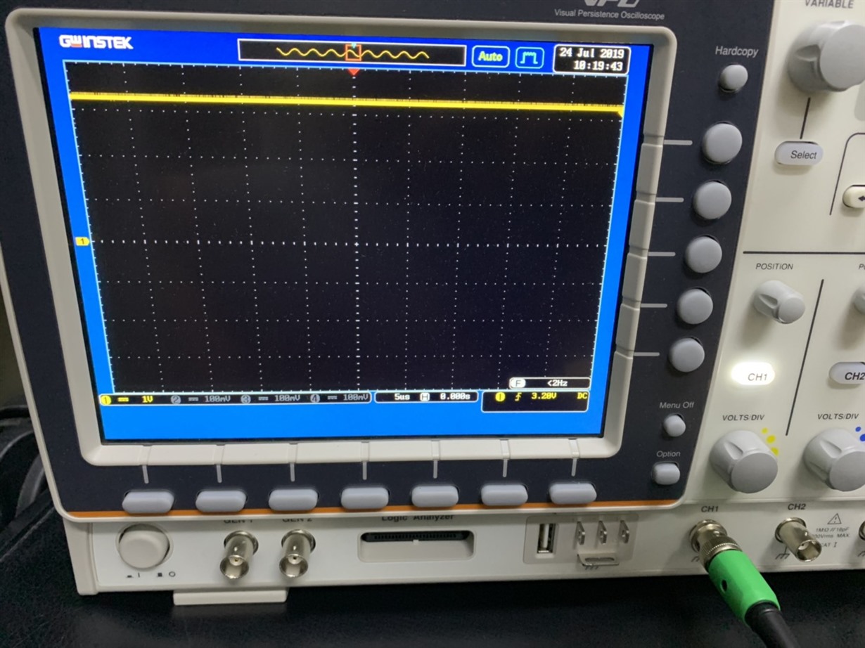

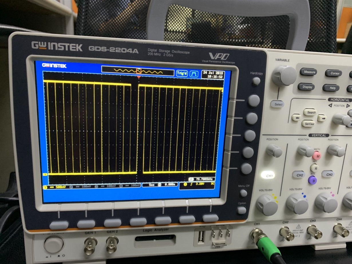

    Currently, I measured the eCAN_B (GPIO 12 17) using a digital storage oscilloscope.
    This is the signal I measured.( GPIO 12 17 )

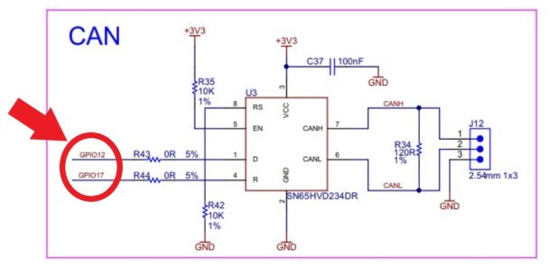

    This is the pin position I measured.

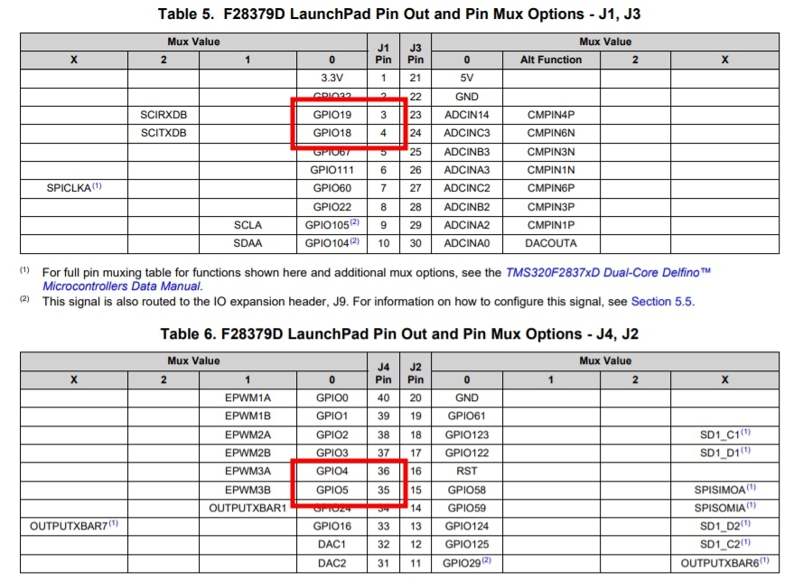

    After that, I measured the eCAN_A (GPIO 3 4 , 19 18 ) using a digital storage oscilloscope.
    This is the signal I measured. All signals are high level !! I think it is not turned on the CanBus function.

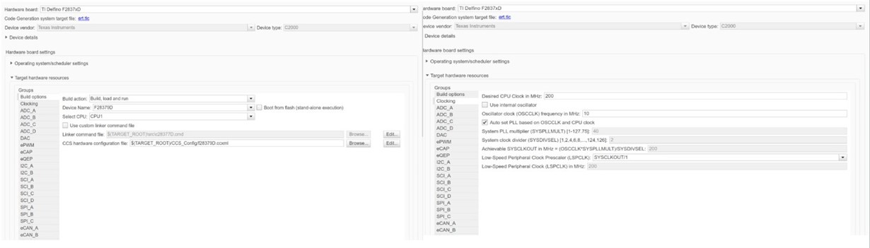

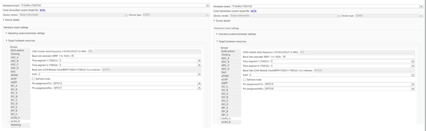

    This is all my settings. I can't find other settings about CanBus.
    The conclusion is that I can't find other settings to enable eCAN_A to turn on the GPIO (4 5 or 19 18) .

    The reason we don't see signal on other GPIO pins is because they are not connected to SN65HVD23x CAN Transceivers.
    This component will generate the CAN Bus signal CAN-H and CAN-L. In the Absence of the Transceivers this conversion does not happen and we cannot view the CAN signals.
