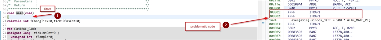

We are using the F2837XD in our prototype under development , and we require some function in code to execute from the RAM ,the code itself will be load externally  by another component  (FPGA) which will instruct the DSP  to load it to specific RAM location and to run it.
a. for test purpose i have created such function  as follow  (the function will be place in section .control )
#pragma CODE_SECTION(servo_init,".control");
void servo_init(void)
b. in the linker file  i assign   RAMGS0123 (it is RAMGS0-RAMGS3)   to page 0  to be as code memory  , and .control  section to reside in RAMGS0123
MEMORY
PAGE 0 :
  RAMGS0123      : origin = 0x00C000, length = 0x004000
PAGE 1 :
SECTIONS
.control:{
Control.obj(.control,.econst,.text,.switch,.cinit,fpga_in)
IDM_ICM_HAL.obj(.servo_hal,.econst,.text,.switch,.cinit)
} >RAMGS0123 PAGE = 0, ALIGN(4)

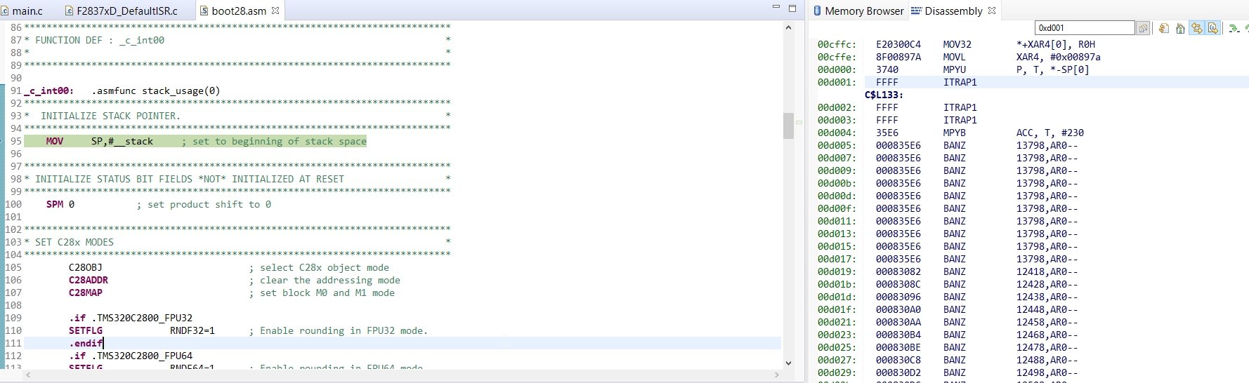

c.for debug purpose i have loaded the image to the target , and rely  on the fact that the debug probe will place my code (servo_init() )  in the proper place in the RAM (RAMGS0123)

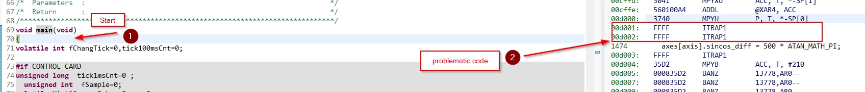

d.when i run the code and enter servo_init() few lines are executed , but i have encounter TRAP  (illegal OP code ) , when debugging again i have looked at disassembly  view and found the following
in the picture below the assembly command is executed and then two ITRAP1 command are inserted , which i don't quite understand why ?
is this normal behavior ?  am i missing something in the linker command  file ?
