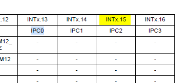

    I have just gotten back to the code.  As of today cpu2 does not receive an interrupt despite the fact that IPC2 is set on CPU1, here are what I believe to be relevant info:
     InitPieVectTable();
        IpcRegs.IPCCLR.bit.IPC2 = 1;
        PieCtrlRegs.PIEACK.all = PIEACK_GROUP1;
    //enable PIE interrupts
        PieCtrlRegs.PIEIER1.bit.INTx14 = 1;  // Enable IPC2 ISR
    interrupt void IPC2_ISR(void)
        uint32_t length;
        void* dataLocation;
            IpcRegs.IPCRECVCOM = 1;
            dataLocation = (void*)IpcRegs.IPCRECVADDR;
            length = IpcRegs.IPCRECVDATA;
            IpcRegs.IPCACK.bit.IPC22 = 1;
            memcpy(RECV_MSG_RAM, dataLocation, length);
            IpcRegs.IPCSET.bit.IPC31 = 1;
            IpcRegs.IPCACK.bit.IPC2 = 1;
    I have enables group one interrupts, intM, and DBGM on CPU1 as well
    Following code (acknowledging the interrupt) should be inside ISR because it needs to be done for each IPC interrupt.
    Also you are expecting IPC2 interrupt where as you are enabling IPC1 interrupt (IPC2 is INT15). Right ?
    Please correct this and see if that helps.
