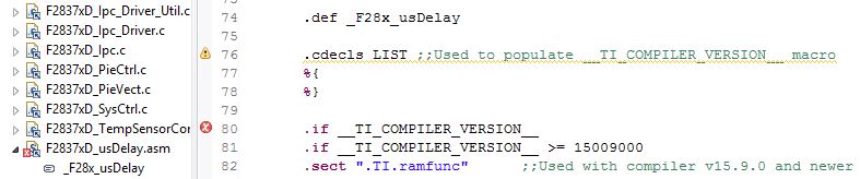

Path "F:/ti/ccs910/ccs/tools/compiler/ti-cgt-c2000_18.12.2.LTS/include" is correct.
In file F2837xD_usDelay.asm a warning and an error are marked but there is no information about errors.
What should be the problem?
