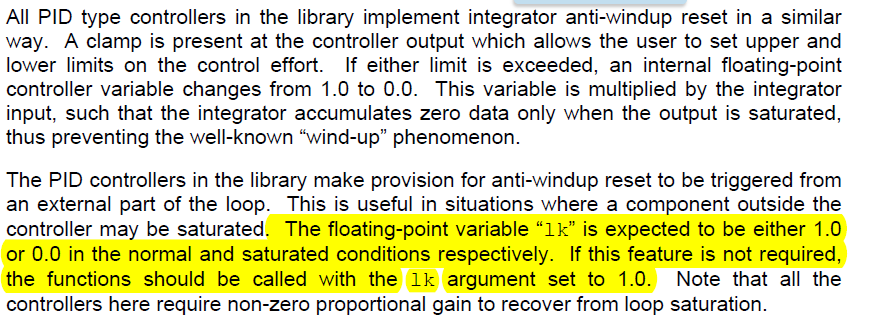

Hi guys,
As stated below on page 42 of DCL user's guide, lk must be set to 1.0. I would like to know if this "1.0" is a logic high (3.3V) or a 0X0001 ?. Because in the F28069 example on CCS, I found this line in the interrupt routine:
lk = (float) AdcResult.ADCRESULT1;  // external clamp for anti-windup reset
DCL_runClamp_C1(&lk, 1.0f, 0.0f);
Which I undertstant that lk is an analog input (0 - 4096).
Please note also that I had to use DCL_RUNCLAMP_C2 instead of C1 since I am having build error on C1.

    The "lk" argument to the controller is a floating-point number which should always be either 1.0f or 0.0f.  In that sense it could be thought of as a logical input, but it is a floating-point number which should only ever be one of those two values.  It's purpose is to enable the integrator to be reset if a part of the loop outside the controller saturates.
    What happens in the example code is that ADC result is formatted as a float and stored as "lk".  The clamp function should test this value tested to determine if it lies in the range +1 to -1 (arbitrary values for this example), then call the controller with either 0.0f or 1.0f depending on the result. So, I think the example code is wrong because it does not use the result of the clamp.  I will note that for revision in the next version.
    I think the code should be something like this:
    float32_t x;
    x = (float32_t) AdcResult.ADCRESULT1;
    lk = (float32_t) DCL_runClamp_C1(&x, 1.0f, 0.0f);
    uk = DCL_runPID_C4(&pid1, rk, yk, lk);
    The only major difference between the clamp functions is that C1 is implemented in assembly, while C2 is an inline C function.  Did you add the assembly file "DCL_clamp_C1.asm" to your project?
    BTW, from the page number you quote I think you might be on v3.1 of the DCL.  At some point you may like to download the latest version of C2000Ware which contains v3.2 of the library.  The PID controllers are the same, but you will find a few minor enhancements.
    Thanks for pointing this out.
    Richard

  • Hi Christian,
    When you add any of the DCL assembly modules to your project you'll have to declare the "dclfuncs" section in your linker command file.  In most cases you can put it in the same memory block as your .ebss section without any issues.  There are examples of this in the DCL linker files at:
    C:\ti\c2000\C2000Ware_2_00_00_02\libraries\control\DCL\c28\cmd
    The clamp function returns a 16-bit integer, either 0x0 or 0x1, depending on whether the variable (vk in this case) has saturated or not.  You can't pass the result to the controller because that expects a float.  If you look back at my previous post, the return value from the clamp function was typecast as float:
    You also need to typecast vk in your code, because the RESULT register contains an integer and the clamp expects to see a float.  Please look again at the example above.
    Richard
