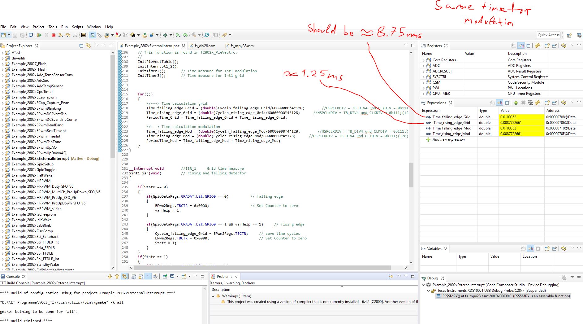

Hello Everyone,
I have a problem with my C200 Piccolo microkontroller.

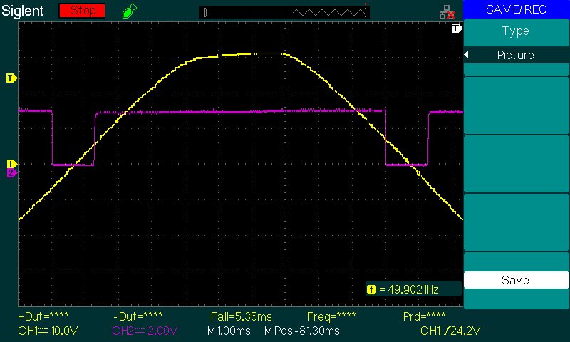

I would like to measure the time with an Interrupt Service Routine .
The signal wich I measur is in der picture below. the high time is 8.75 ms und the bottom time is 1.25 ms,
wich I measured with an oscilloskope.

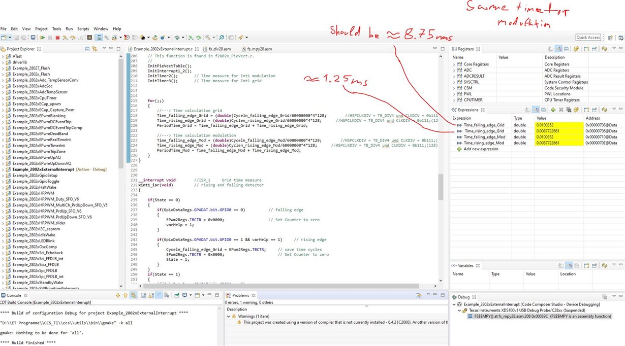

My problem is that I cant measur the right time with the microkontroller, once I test the programm with one timer and one interrrpt it works, but now it doesnt work anymore and the old programm too.
The time I measur with the microkontrolle is in the picture below too (purple line).
The wrong time I measure is also in the picture below (yellow market).
Do you have any ideas where is the problem?
