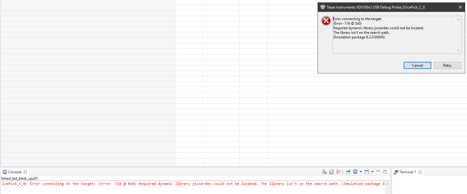

LAUNCHXL-F280049C: Error while uploading ending in process terminated.
Part Number: LAUNCHXL-F280049C
Other Parts Discussed in Thread: C2000WARE,
I have the latest version of CCS and a brand new F280049C.
Above error occurs when uploading to board. I can only get 1 or 2 example programs to fully load properly. I cannot find this file anywhere.
Will this file, if installed, allow all the demos to upload and run? Can I get the file from this forum? If so, i'll be greatful.
  • Hi Darryl,
    This dynamic library should be in your CCS directory, for example C:\ti\ccsX\ccs\ccs_base\common\uscif
    Did you install CCS in your C-drive? If you are missing this dynamic library you might be missing others as well. Please uninstall and re-install CCS to see if that solves the issue.
    Also, please check out the following post: https://e2e.ti.com/support/microcontrollers/c2000/f/171/t/490091
    The post describes a similar problem that was solved by uninstalling and then reinstalling CCS without an antivirus software.
    Marlyn

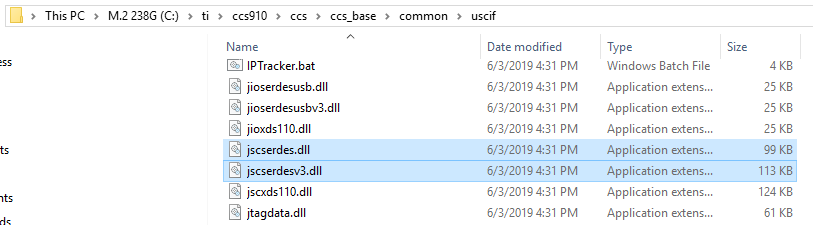

  • Marlyn;
    I uninstalled ccs9 then reinstalled it. Same same.
    However, the project I intend to work on loads just fine.
    But I want to work thru the examples first.
    As you can see in the captures, I do have the file right where you said it would be.
    Any more ideas?
    Darryl

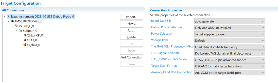

  • Darryl,
    The error seems to indicate what Marlyn mentioned: a faulty install. However, since you showed the files present on the CCS install directory, I have another suspicion.
    If you are using the built-in debug probe of the The LAUNCHXL-F280049C, its model is the XDS110 Debug Probe, not the XDS100v2.
    This is a common occurrence if you created/imported a project from the C2000Ware, since all the current projects seem misconfigured and point to the XDS100v2.
    Please check the short clip below to learn how to proceed to change this:
    https://youtu.be/4ZoXwM3-Szw
    Hope this helps,
    Rafael
  • Rafael
    I successfully loaded the correct debug version. Capture 3 is the result.
    Marlyn
    The project is located in the same folder as the examples after i imported them. (C:\Users\Darryl\workspace_v9)
    Yes, loadable examples load every time.
    I switched out the cable but same result.

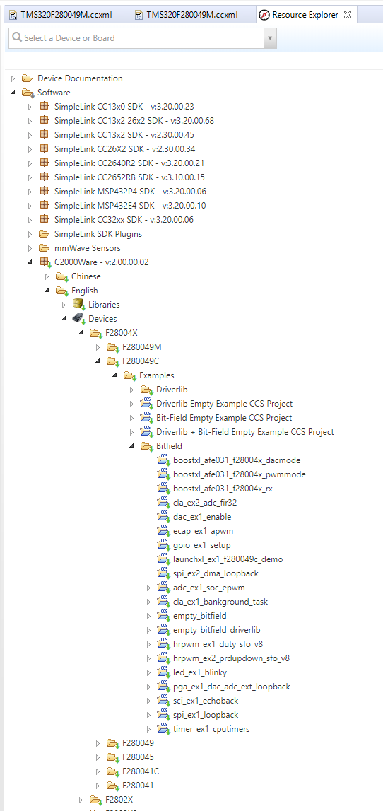

    I uninstalled the old drivers and installed XDS Emulation Software Package, then tried to load project and got the following. (capture 4)
  • Darryl,
    After installing the drivers again were you able to see the 'Texas Instruments Debug Probes' in Device Manager?
    Could you please try using another USB port on your computer.
    If that still does not work then we can try something else,
    Please navigate to the directory that is shown in (Capture 4) screenshot you provided. Open the 'XDS110SupportReadMe' file and follow the steps for 'Updating the Firmware Using xdsdfu'. Something might have gone wrong while re-installing the drivers. After you have done this try to connect and load a program again.
    Marlyn
  • Darryl,
    As Marlyn mentioned, the error shown in your last capture is indicative of a probe that is unable to be found by CCS - this can be caused by a problem in the install or the drivers themselves. Additional details can be found at the Debugging JTAG page below (just search for the error number 260).
    http://software-dl.ti.com/ccs/esd/documents/ccs_debugging_jtag_connectivity_issues.html
    For details on the device drivers, etc. please check the section troubleshooting of the XDS110 page at:
    http://software-dl.ti.com/ccs/esd/documents/xdsdebugprobes/emu_xds110.html
    The page above contains additional details on how to update the firmware and troubleshoot other scenarios.
    By the way, the Capture3.PNG file still shows the XDS100v2 in the title of the dialog box.
    Rafael
