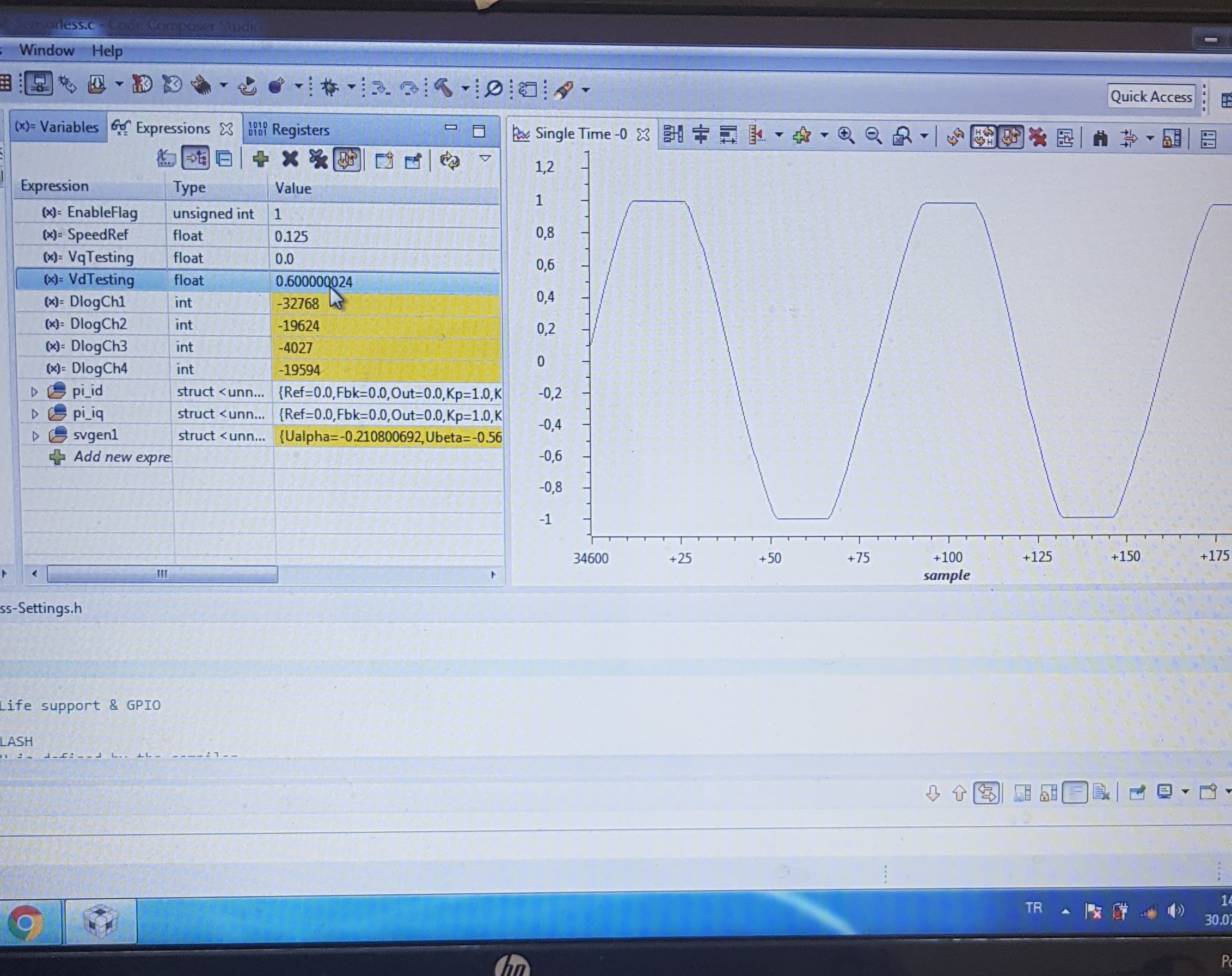

İpark1.Alpha and İpark1.Beta   signal range is between -1 and +1 (maximum duty cycle of İpark) . Here is very good.
But Svgen1 maximum duty cycle is  between -0.5 and +0.5.
How can ı change the maximum duty cycle of svgen  between -1 and +1.
When ı set Vdtesting=0.5, Vqtesting=0,  İpark1.Alpha= between -0.5 and 0.5,  İpark1.Beta= between -0.5 and 0.5,  svgen1.Ta-svgen1.T=between -1 and +1. it is sinüsoidal.
When ı set Vdtesting=0.6, Vqtesting=0,  İpark1.Alpha= between -0.6 and 0.6, İpark1.Beta= between -0.6 and 0.6, svgen1.Ta-svgen1.T=between -1 and +1. it is not sinüsoidal and it is saturate.
I attached the svgen1.Ta-svgen1.Tb picture. it deteriorate after -0.5 and +0.5.
