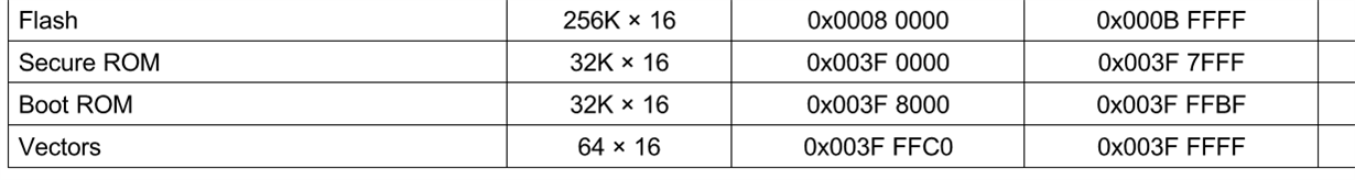

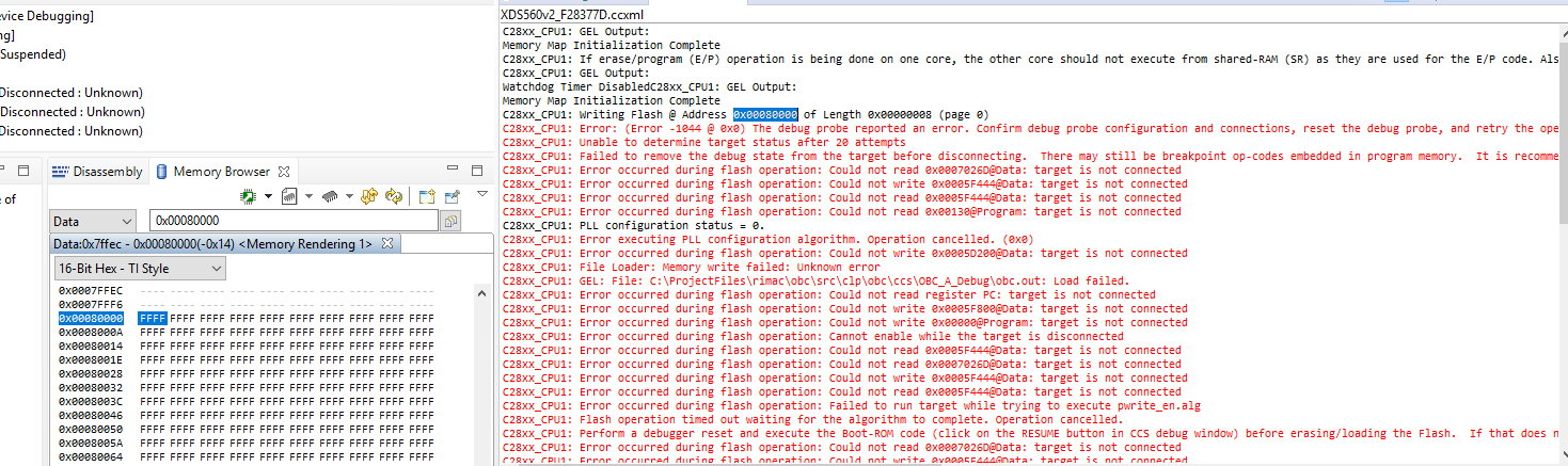

1. Set Boot mode pins (GPIO72,GPIO84) to 1,0 respectively to get the MCU into WAIT mode and try to flash the firmware. Output I get is
C28xx_CPU1: GEL Output:
Memory Map Initialization Complete
C28xx_CPU1: If erase/program (E/P) operation is being done on one core, the other core should not execute from shared-RAM (SR) as they are used for the E/P code. Also, CPU1 will be halted to determine SR ownership for the CPU which will run the Flash Plugin code, after which CPU1 will be set to run its application. User code execution from SR could commence after both flash banks are programmed.
C28xx_CPU1: Writing Flash @ Address 0x00080000 of Length 0x00000008 (page 0)
C28xx_CPU1: Error: (Error -1135 @ 0xC095) The debug probe reported an error. Confirm debug probe configuration and connections, reset the debug probe, and retry the operation. (Emulation package 8.2.0.00004)
C28xx_CPU1: Trouble Halting Target CPU: (Error -1044 @ 0x0) The debug probe reported an error. Confirm debug probe configuration and connections, reset the debug probe, and retry the operation. (Emulation package 8.2.0.00004)
C28xx_CPU1: Unable to determine target status after 20 attempts
C28xx_CPU1: Failed to remove the debug state from the target before disconnecting.  There may still be breakpoint op-codes embedded in program memory.  It is recommended that you reset the emulator before you connect and reload your program before you continue debugging
C28xx_CPU1: Error occurred during flash operation: Could not read 0x0007026D@Data: target is not connected
C28xx_CPU1: Error occurred during flash operation: Could not write 0x0005F444@Data: target is not connected
C28xx_CPU1: Error occurred during flash operation: Could not read 0x0005F444@Data: target is not connected
C28xx_CPU1: Error occurred during flash operation: Could not read 0x00130@Program: target is not connected
C28xx_CPU1: PLL configuration status = 0.
C28xx_CPU1: Error executing PLL configuration algorithm. Operation cancelled. (0x0)
C28xx_CPU1: Error occurred during flash operation: Could not write 0x0005D200@Data: target is not connected
C28xx_CPU1: File Loader: Memory write failed: Unknown error

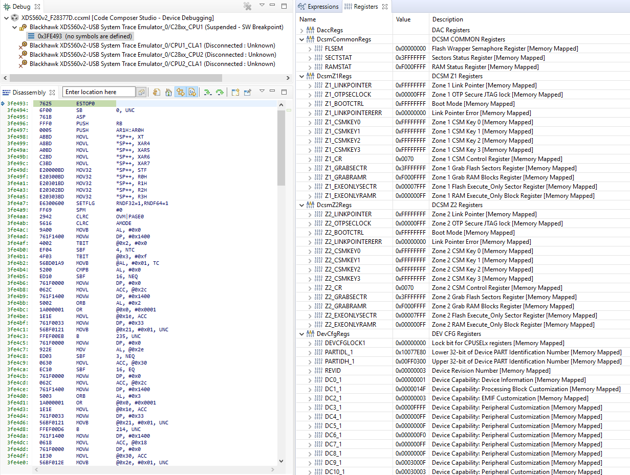

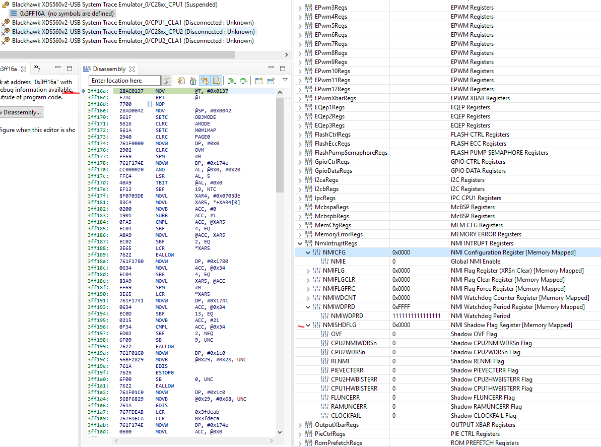

2. Instead of flashing code, connecting to the MCU via debugger to see what is happening inside (Using the same .ccxml as the Debug Configuration).

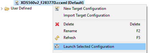

I Launched the .ccxml from the Target Configurations in CSS and Connected to the CPU 1 core. Great. Do System Reset then CPU Reset.

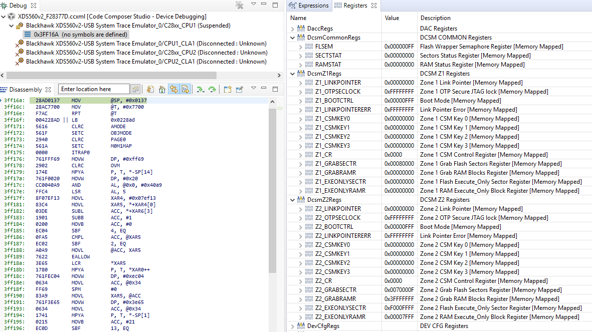

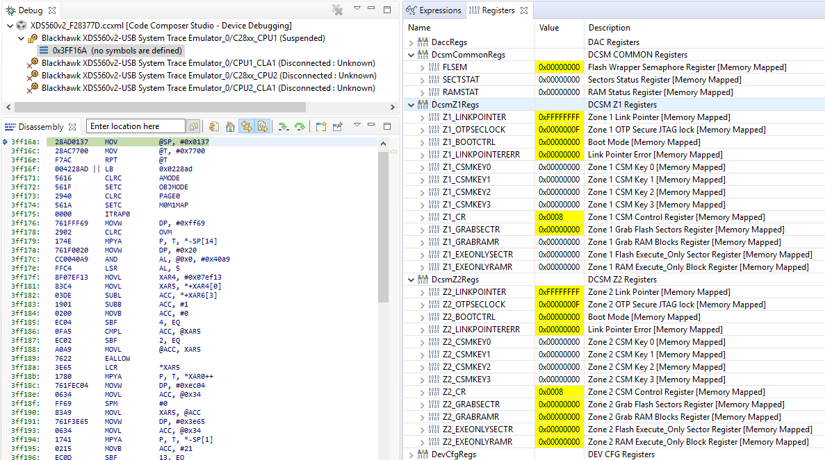

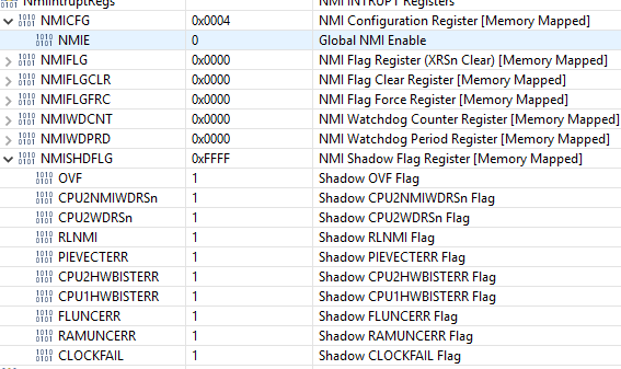

Looking at the Disassembly tab, I can see that the Program Counter is at 0x003FF16A. Looking at the Delfino user manual, it seems that this is somewhere within the Secure ROM area.
I let the code execute and it gets itself into ESTOP0, the Program Counter is at 0x003FE2ED which is within the Boot ROM space. The MemoryErrRegs, RomWaitStateRegs and RomPrefetchRegs registers are all 0s.

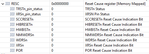

RESC register shows that XRSn and TRSTn are 1, everything else is 0.

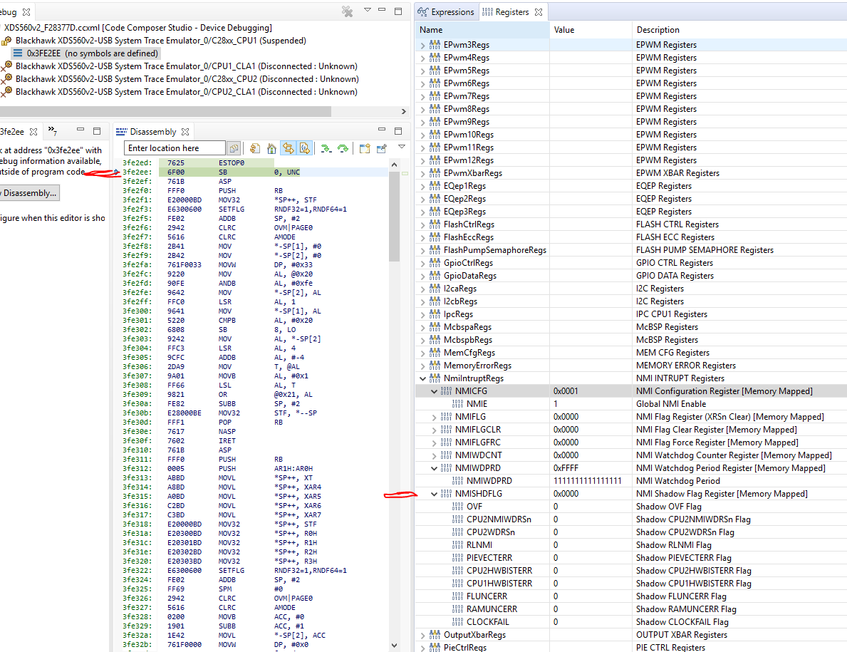

3. Return Boot Mode pins both to HIGH, so the Boot ROM jumps to Boot from Flash instead of Wait.
Again, Launch Target Configuration connecting to the target, System Reset, CPU Reset, let the code to execute, it stops at ITRAP0 @0x0 from 0x0F189 (GS3 RAM)?

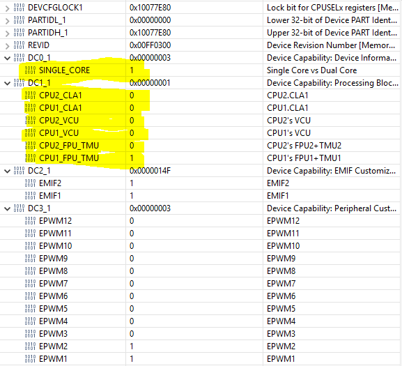

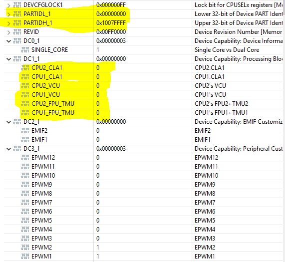

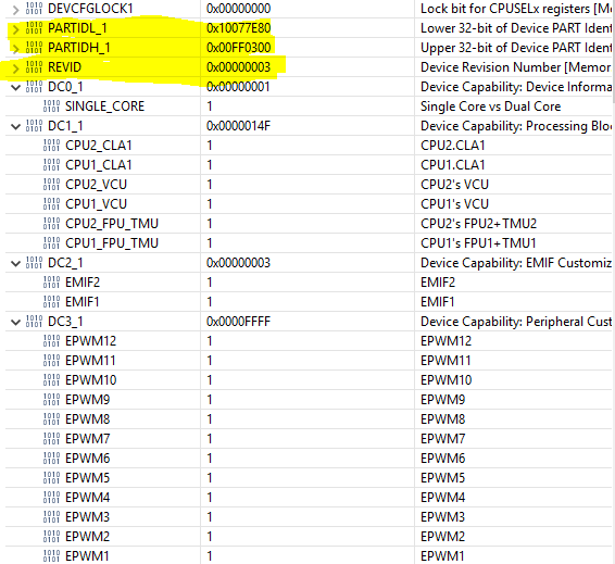

    I had a look at the PARTIDL_1 and PARTIDH_1 registers. This is what I found. Green - Flashed, Red No _Flash.
    Board 1 0x10077E80 0x00FF0300
    Board 2 0x10077E80 0x00FF0300
    Board 3 0x10077E80 0x00FF0300

    Error tells me that the Device Identification registers read by Flash Plugin are incorrect.  In debugger memory window, can you open the memory browser to locations 0x700B0 and 0x700B1 and tell me the values you see there?  In the past, similar debugs ended up as board issues on customers' side (same case - where some boards were fine but others were failing).  Please double check everything on your side.

    On the board that I can flash Memory locations 0x0700B0 and 0x0700B1 have values 0x5303 and 0x7715 respectively.
    On the board that I cannot flash the Memory locations 0x0700B0 and 0x0700B1 have values 0x06BE and 0x7715 respectively.
    So I re-checked both MCUs and now the memory locations have the same values on both MCUs: 0x5305 and 0x7715. I still can only flash one of the boards.
    I've also noticed that sometimes the value in register 0x700B0 will be 0x0200 on the board that does not flash.

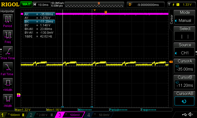

    I scoped the XRS line and it was not dropping as I was trying to flash. However When the Boot Mode pins are HIGH the XRS line does this strange pulsing

    The 1V2 does not drop, the 3V3 also does not drop.

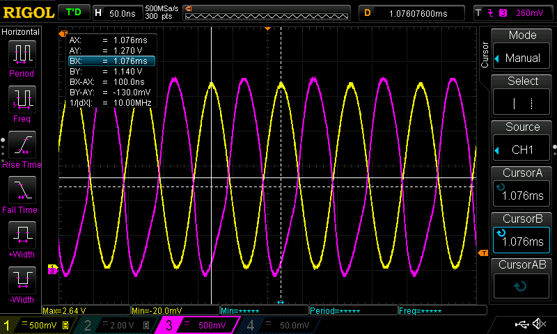

    I looked the Crystal traces on my PC, I can see 10MHz traces look ok.

  • I am looking a little more in depth at the Device Identification registers on the MCU that I cannot flash. The values do not seem to match the datasheet.
    When I look at the Register, I see this
    It thinks, its a Single Core with 2 EPWM modules?
    For comparison, here are the register values for a MCU that I can flash.
    It seems that the data is shifted incorrectly on the non-working MCU which corrupts the Boot process?
    edit:
    Connected to another board that cannot be flashed and the Device identification seems to be corrupt too.

    Did you reset the board and run the BOOTROM before reading the DCx register. It look like the BOOTROM has not run hence all the values are not populated. After connecting the CCS, issue debug reset from CCS and then click the run icon and after CPU halts, read the DCx register.

    Thank you for your input, these are the steps I've carried out:
    Launch Target
    Connect tot CPU 1
    When the debugger connect to the core, the CPU seems to be reset and the debugger stops at specific memory location.
    I then manually pull the XRS line low to reset the device and debugger shows updated registers. Execution starts from the same place too.
    When I press the Run button on CCS, the execution gets into ESTOP0 loop.
    I can see however that this time the Device Information registers are also configured as the other boards that I can flash.
    My Boot pins are both HIGH.

    Good. So device configuration is same on both board which is expected. Now, on the board which you are not able to flash, can you try loading the code after all the steps are performed (as you mentioned in post) and device configuration register have proper value. If that works then you need to change the BOOTMODE pin setting so that it's not BOOT to flash (1/1) and try flashing the board again after power-up.

    edit:
    Just for completion I looked at the 0x00800000 address and all memory after it is all 0xFFFF.
  • Can you check the value in RESC register and NMISHDGLF register after you see the error message ?
    Vivek Singh
    Here are the RESC registers.
    And NMISHDGLF
  • Values in NMISHDFLG does not make sense. It can be 0xFFFF. Reset value for this one is 0x0 and we can not have all the error status bit set to '1'. Can you check this again.
    Vivek Singh
  • Vivek,
    I retried, these are the values after I reset the MCU via CCS.
    These are the values when I try to Load Program via CCS.
    The console output is this
    C28xx_CPU1: Flash Programmer: Warning: The configured device (TMS320F28377D), does not match the detected device (). Flash Programming operations could be affected. Please consider modifying your target configuration file.
    C28xx_CPU1: Trouble Setting Breakpoint with the Action "Remain Halted" at 0xc0eb: (Error -1066 @ 0xC0EB) Unable to set/clear requested breakpoint. Verify that the breakpoint address is in valid memory. (Emulation package 8.2.0.00004)
    C28xx_CPU1: Breakpoint Manager: Retrying with a AET breakpoint
    C28xx_CPU1: PLL configuration status = 49387.
    C28xx_CPU1: Error writing the PLL values. (Flash algorithm returned error code). Operation cancelled.
    C28xx_CPU1: GEL: File: C:\ProjectFiles\rimac\obc\src\clp\obc\ccs\OBC_A_Debug\obc.out: Load failed.

    C28xx_CPU1: Error occurred during flash operation: Failed to run target while trying to execute pwrite_dis.alg
    C28xx_CPU1: Flash operation timed out waiting for the algorithm to complete. Operation cancelled.
    C28xx_CPU1: Perform a debugger reset and execute the Boot-ROM code (click on the RESUME button in CCS debug window) before erasing/loading the Flash.  If that does not help to perform a successful Flash erase/load, check the Reset cause (RESC) register, NMI shadow flag (NMISHDFLG) register and the Boot-ROM status register for further debug.
    C28xx_CPU1: Error occurred during flash operation: Could not write 0x00000064@Data: target is not connected
    C28xx_CPU1: Error occurred during flash operation: Could not write register PC: target is not connected
  • Sorry, but it's bit confusing. Earlier you had very different values and now it look correct. What has changed from earlier setup to this one? If you are getting different value each time then setup is not robust.
    Also from below message it look like device ID is not getting read properly but earlier we saw it was ok.
    Have you checked the power supply on board to make sure it's not dipping below spec?
    Vivek Singh
  • I have taken extreme measures and moved the MCU I cannot flash onto another board that I do know works. When I moved the MCU, it functions as expected. I can flash it with no problems.
    I have escalated the issue to our electronics guys to review the differences between the working and not working PCBs.
