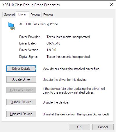

  • My drivers look up to date, version 1.9.0.0 from Oct 8th 2018. No flags in the Windows device manager, the boards were working fine and this problem started happening abruptly.

    Take a look at the FAQ here https://e2e.ti.com/support/microcontrollers/c2000/f/171/t/753823, can you run the XDSDFU utility to see what the loca XDS110 version is?
    The issue described in the FAQ was resolved in the 8.1.0.00005 from March, looks like you have the latest 8.2.0.00004 from June.  To my knowledge there shouldn't have been any changes to effect the 110 for F28004x(famous last words).
    I'll make sure I'm running the latest EMU pack as well and note if the LP works for me.
    In the meantime, you can follow the instruction in the FAQ, and roll back the driver to 8.0.803.0 and see if that gets a temporary soln so you can connect.
