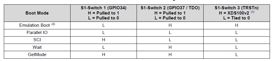

  • Thanks for response,
    I checked the F28069M LaunchPad data sheet and set the S1 switch by following picture:
    But  after powering off and setting S1 to Getmode and powering on, it doesn't work.

  • Typically hitting the debug button in CCS is enough to launch the debug session and load the application. If you aren't sure that it loaded though, you can do it  yourself by going to Run->Load->Load Program and selecting your .out file.
    So are you seeing any sign that your application is even reaching main()? I'm trying to determine where it's getting stuck. Can you try blinking an LED at the start of main() just to see if it's still stuck in boot ROM or if it has reached your application?
