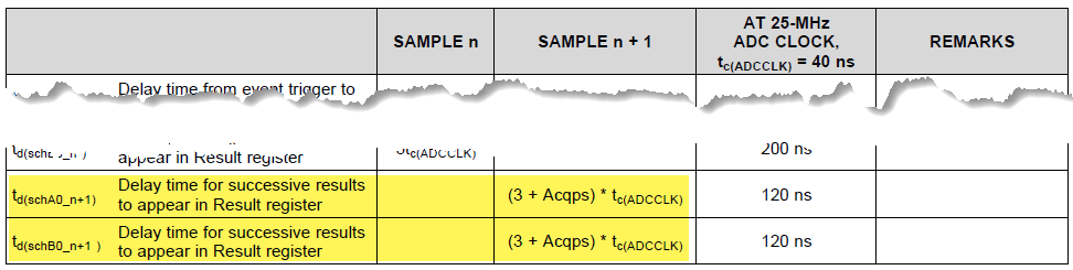

  • Muhammad,
    I'm not sure that I follow your math exactly, but it's usually a really good sign when your calculated sampling rate matches observations.  Generally, once you get past the initial conversions, the ADC pipeline becomes the dominant contributor to the sampling rate so these line items for successive results will take over:
    If you are slowing down the ADC in order to achieve a certain sampling rate, you will often be better off configuring the ADC to operate at full speed in Sequencer Override mode and use EPWM triggers to determine the sampling rate.  This will make it much easier to adjust and confirm your sampling rate, and it allows you to tune your other ADC settings (like ACQ_PS window) without affecting your effective sampling rate.
    -Tommy
