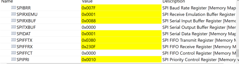

I have configured TMS320F28335 as a master and wifi module as slave over SPI. So master sending command and Wi-Fi module responding as expected,as I have observed on Wi-Fi debug tool.
SPI transmission working fine,when I am sending System RESET command Wi-FI module responds with wifi_evt_sytem_boot as shown in the below screenshot
At MISO pin I have obseved that I am getting data as send by the Wi-Fi module.But at RXBUF I am getting only three words,Please find below value of SPIFFRX register which shows value of numer of character receivedv i.e. 3
SPIFFRX =0x230F;
also find below code that I am using for SPI reception,

Please suggest the solution to read more than 3 words.
