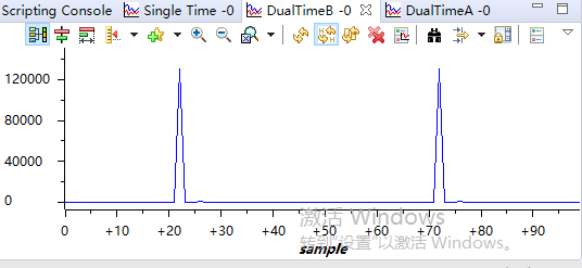

My graphs like this

    Can you give more information regarding the doc you attached (trouble reading.docx)?  It looks like you successfully connected Code Composer Studio to the device?  Is connecting to the device still an issue?
    Is the current problem only with the graphs?

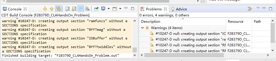

    After build project

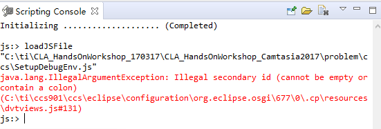

    After scripting

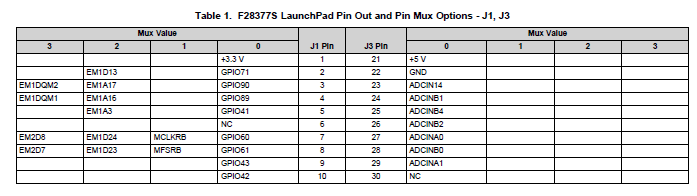

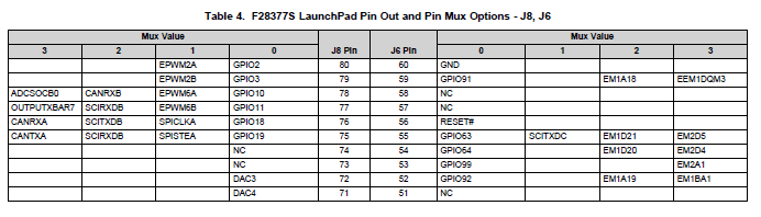

    There is no EPWM4A in F28377S and pin out is
    According to C2000Ware_Device support_F28377S_Examples_cla_adc_fir32_cpu01.c
    EPWM2 is setup to switch at 10KHz. Connect pin EPWM2A to ADCA0
     on the board to see the filtering effect.

  • Jingtai said:
    After build project
    This indicates that a linker command file (.cmd) is missing from the project.  I have imported the "problem" project and see these sections in the file "F2837xD_FLASH_lnk.cmd".  Look in Project Explorer for this file in the problem project.
    Jingtai said:
    After scripting
    In the .js file there is a directory as an input to the openAnalysisView function. It looks like your project is in a different location on your PC.  Update the directories and try.
