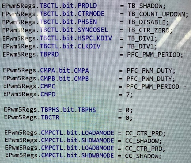

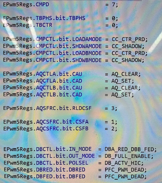

My customer meets trick situations when using EPWM deadband. In duty equals zero situation, some glitch exists on the output.
Below are their configuration.

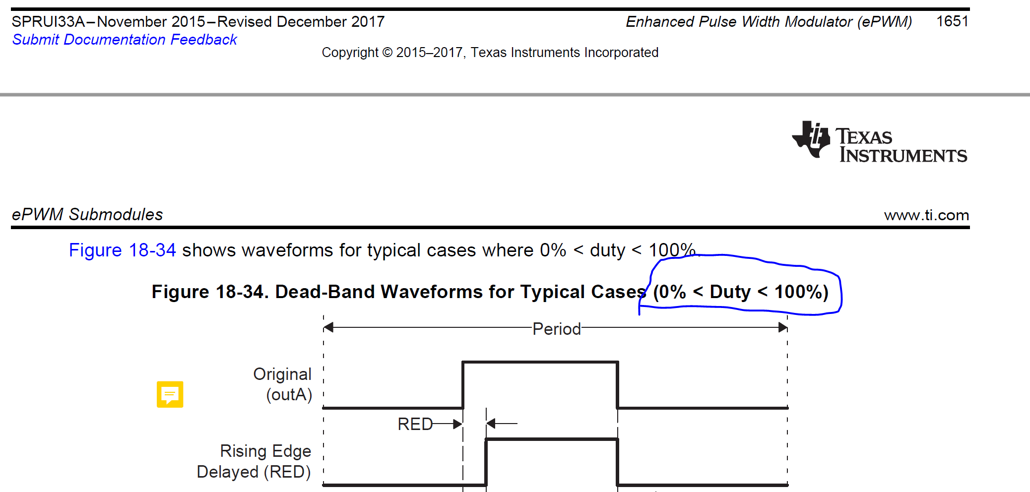

BTW, could you if below page on datasheet including duty equals zero condition?
Sheldon
  • I believe using deadband with  the 0% duty is a limitation. I will get back to you with a definitive answer.

  • Okay after a lot of digging, I found this code I had written a while back. This uses 100% duty and 0% duty with deadband can you have them try it while I check for the deadband limitation?

  • After searching for a limitation on duty and deadband, I still havent been able to find one. I tested the code above and it functions as expected. I will let you know if I find anything that states otherwise.
