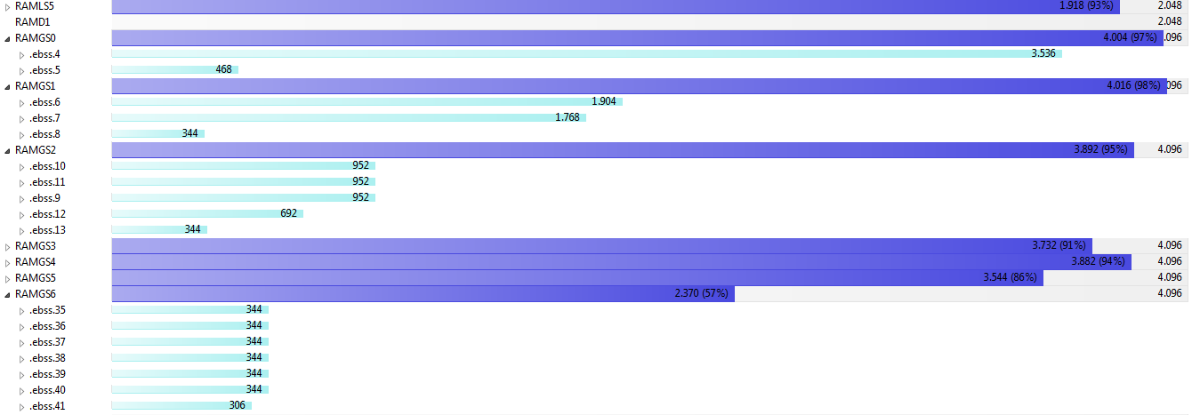

During Linking process, I am getting an error
Description Resource Path Location Type
#10099-D program will not fit into available memory. run placement with alignment/blocking fails for section ".ebss" size 0x9e9a page 1. Available memory ranges: 2837x_FLASH_lnk_cpu1.cmd /quad_CCS line 101 C/C++ Problem
This is my linker file command line for .ebss section
.ebss : >> RAMLS5 | RAMGS0 | RAMGS1 | RAMGS2 | RAMGS3 | RAMGS4 | RAMGS5 | RAMGS6 PAGE = 1
But other sections are getting allocated without any problem

Can you make the RAML5 be the last memory range in the .ebss assignment. Additionally, if there's still not enough space, you can consider combining one more block of GS RAM and see if that helps. Is your current linker cmd file built of the example linker files provided in C2000Ware? Do you have a lot of global variables in your application?

1) I placed the RAMLS5 as last memory range but still .ebss.1 remained unallocated. I can see there is mamory available in RAMGS10_11 but the linker is not linking this memory block for some unknown reason.
2) I have combined RAMGS0 till RAMGS11
3) Current linker file using is one which is provided in C2000ware
4) Yes, My application consists of more global variables

Can I make use of RAMGS14 and RAMGS15 on PAGE 0 for .ebss section (Which uses memory of PAGE1)?. If yes, please tell me how to initialize it.
