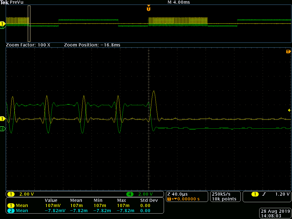

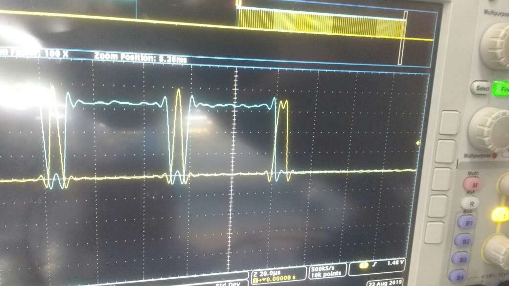

TMS320F28069M: Problem while software force off
Part Number: TMS320F28069M
Other Parts Discussed in Thread: DRV8312, C2000WARE
I am using driver IC UCC27201AQDDARQ1 with transistor to drive BLDC motor, I have changed the code BLDC_Censored which is for DRV8312 for the dead band, My problem is there is a slight overlap between ePWMA and ePWMB at the end, please let me know if there is some mistake in code. I am attaching code and waveforms here.
#define DEAD_BAND   10
#define OUT_MODE_ENABLE   3
#define IN_MODE_EPWMA 0
EPwm1Regs.DBCTL.bit.OUT_MODE = OUT_MODE_ENABLE;
EPwm2Regs.DBCTL.bit.OUT_MODE = OUT_MODE_ENABLE;
EPwm3Regs.DBCTL.bit.OUT_MODE = OUT_MODE_ENABLE;
EPwm1Regs.DBCTL.bit.POLSEL = 2;
EPwm2Regs.DBCTL.bit.POLSEL = 2;
EPwm3Regs.DBCTL.bit.POLSEL = 2;
EPwm1Regs.DBCTL.bit.IN_MODE = IN_MODE_EPWMA;
EPwm2Regs.DBCTL.bit.IN_MODE = IN_MODE_EPWMA;
EPwm3Regs.DBCTL.bit.IN_MODE = IN_MODE_EPWMA;
EPwm1Regs.DBRED = DEAD_BAND;
EPwm1Regs.DBFED = DEAD_BAND;
EPwm2Regs.DBRED = DEAD_BAND;
EPwm2Regs.DBFED = DEAD_BAND;
EPwm3Regs.DBRED = DEAD_BAND;
EPwm3Regs.DBFED = DEAD_BAND;

      EPwm3Regs.AQCTLA.bit.ZRO = 1;                 /* Set low when CTR = Zero                          */\
      EPwm3Regs.AQCTLB.bit.CAU = 1;                 /* Set low when CTR = Zero                          */\
      EPwm3Regs.AQCTLB.bit.ZRO = 2;                 /* Set high when CTR = CMPA on UP-count             */\
      EPwm3Regs.CMPA.half.CMPA = (int16)(Tmp>>15);  /* PWM signal on output B of EPWM3 (Q15 -> Q0)      */\
      /*EPwm3Regs.AQCSFRC.bit.CSFA = 2;*/               /* Forcing a continuous High on output A of EPWM3   */\
      EPwm1Regs.DBCTL.bit.OUT_MODE = 0;                                              \
      EPwm2Regs.DBCTL.bit.OUT_MODE = 3;                                              \
      EPwm3Regs.DBCTL.bit.OUT_MODE = 3;                                              \
