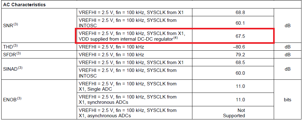

  • Hi PAN,
    There is a small degradation in ADC SNR when the DC-DC is used. It's specified in the datasheet.

  • PAN,
    Thank you for the reply, Do you have any numbers for ADC accuracy using  internal supply VREG (LOD internal supply) with internal CLock?
    There is no performance difference in the ADC whether using internal or external LDO because there is no switching. The screen capture i sent in the previous reply shows the ADC performance with the internal oscillator.
    Can we assume that internal oscillator with DC-DC regulator is more efficient than DC_DC with external ?
    I'm not clear on what you are basing this on. Oscillator source doesn't make a big difference in power consumption. If you are concerned about power consumption, you will get the biggest gains by disabling clocks to unused peripherals.
    In case we use the DC-DC regulator, should we connect the VREF of the ADC to an external 2.5V ?
    External ADC reference will give better ADC performance whether using the LDO or DCDC.
    Sorry would you have those numbers for 3.3 refernce, please?
    3.3 reference will give the same or better performance compared to 2.5 reference.
     As for power consumption, i leave exact computation for my electronics engineer, i just like to know if you d have a method to estimate power consumption of a standard motion control application, and estimate if i can go with the DC-DC regulator..
    There are multiple ways to accomplish this. The basic idea is you run your application (doesn't matter what the application is) for some time and then measure the current on the rails (VDDIO, VDDA, VDD). You can either measure peak current, avg current or log the current over time.

  • PAN,
    1.
    i. Yes, the switching here refers to the DC-DC. The DC-DC switches whilst the LDO does not.
    ii. It depends on what you mean by performance. The only advantage the DC-DC has over the LDO is efficiency.
    iii. As pointed out in the prior post, when using the DC-DC, the ADC will experience some performance degradation and it is heavily PCB layout dependent. This is one of the trade-offs you will have to make when moving from the LDO to the DC-DC. If best ADC performance is your priority, then you will need to stick with the LDO.
    2. Yes, we have a table in the datasheet that lists power consumption per disabled peripheral. This table was derived by running a specific test under a set of conditions. It is a very rough estimate and not 100% representative of every one's use-case. It's good for sizing your external supply. For the most accurate power consumption, you will need to measure the currents for your specific system under all possible operating conditions your system will experience.
    3. Our internal DC-DC is about 80% efficient. An external DC-DC can be more efficient than this but will not be a 0 cost add-on.
