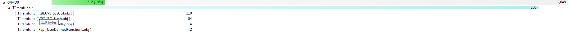

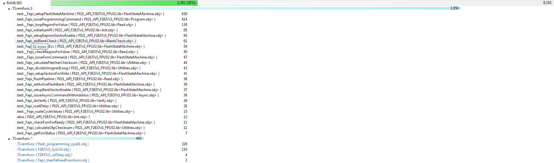

  • Hey Vamsi,
    I have simply built the example given in C2000 to see if it works on the processor I have. It does, but the memory allocation of ramfuncs appear to be in different places.
    In the example, TI.ramfunc.1 and .TI.ramfunc.* are located within RAMLS03, along with FLASHD.
    In my project, I just seem to have TI.ramfunc.* located in RAMD0 (where i link it to). I can't seem to find the TI.ramfunc.1 object.
    Is there any reason why this is happening?

  • Above is the memory allocation for Ti.ramfunc located in RAMLS03, as specified in the linker.
    Above is the memory allocation for Ti.ramfunc located in RAMD0, changed to that location in my project. It appears there is a section of TI.ramfunc missing? My linker is described in the first post.
  • Robert,
    .TI.ramfunc.1 is created by the linker since Flash API library and .TI.ramfunc section are GROUPed in the linker cmd.
    You mentioned that you also GROUPed these two in your linker cmd file.
    But the memory allocation of your project does not show the Flash API. Can you share your linker cmd file and map file so that I can take a closer look?
    Few other things to check in your project:
    1. Make sure the functions that call the Flash API are also mapped to Flash for load and RAM for run. For example, Program_FlashAPI() in your project.
    2. Make sure to not erase the sectors that have Flash API in it.
    3. Make sure to always program ECC along with Flash content. In your code, I see you use Fapi_DataOnly parameter for program command.  I would suggest to program the ECC as well, using Fapi_AutoEccGeneration parameter. If not, ECC errors will occur.
    Thanks and regards,
    Vamsi
