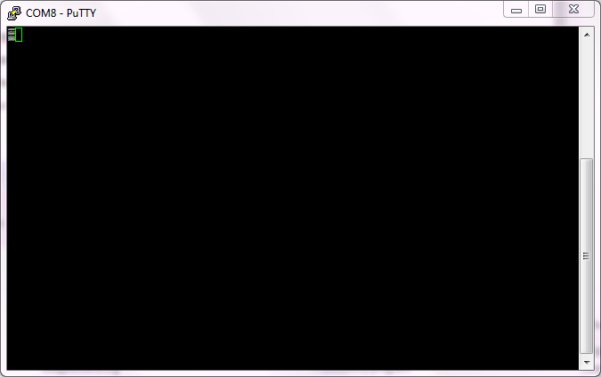

  • Hi Vamsi,
    Thank you for your answer.
    I have tried on both Putty and Hyperterminal.  I have set up speed (baud) 9600, Data bits 8, stop bits 1, parity none, Flow control None.
    On Putty, some strange symbol quickly appears and then disappears. Only one rectangular remains as following figure. I have checked that symbol on https://www.rapidtables.com/convert/number/ascii-to-hex.html  and the hex value is 2592. It does not belong to ASCII table.
    On the Hyperterminal, nothing happen. The LED D7 and D8 on the LaunchPad were blinking when I typed, it means some data is transferred.
    I have not changed the clock setting of the CPU (200 MHz) or SCI Baud rate, so the SCI speed should be 9600.
        SciaRegs.SCIHBAUD.all = 0x0002;
        SciaRegs.SCILBAUD.all = 0x008B;
    As I understand. The unknown symbol appeared when the data received is not correct. It can be baud rate. But the baud rate of both TMS320F28379D and terminal are the same. Is there other possible cause?

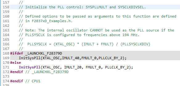

    On an other hand, I found that the "_LAUNCHXL_F28379D" is defined in file "F28xProject.h" which are included current project.
    But in the InitSysCtrol() in file "F2837xD_SysCtrl.c", it looks like the "_LAUNCHXL_F28379D" has not been defined yet.
    Is this the problem? If yes, how to solve it?

  • Alex,
    It might be that the symbol has to be added in build settings. Will check and get back to you.
    Thanks and regards,
    Vamsi
  • Alex,
    Please add "_LAUNCHXL_F28379D"  in the project's predefined symbols (Right click on the project -> Show Build settings -> Build -> C2000 Compiler -> Advanced Options -> Predefined Symbols -> Pre-define NAME).
    We have an example with a build config for launchpad in C2000Ware at: ~\C2000Ware_2_00_00_02\device_support\f2837xd\examples\cpu1\blinky
    Thanks and regards,
    Vamsi
  • Dear Vamsi,
    Thank you so much for your time and help.
    The scia in the LaunchPad is working well.
    Alex
