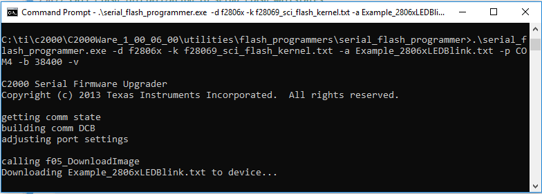

  • Dear Sir,
    I wnat to set "Boot Mode Selected" to GetMode with boot to SCI. I go through the steps as below:
    1. I first set up the switch S1 on f28069 Launchpad to 101 to choose "Boot Mode Selected" to GetMode with boot to SCI.
    2. I then go to the folder C:\ti\c2000\C2000Ware_1_00_06_00\device_support\f2806x\examples\c28\f28069_sci_flash_kernel to build the serial flash kernel file, kern.out.
    3. Then I go to the folder C:\ti\c2000\C2000Ware_1_00_06_00\device_support\f2806x\examples\c28\timed_led_blink to build the application file, app.out. Before, I need change its cmd file from RAM to flash.
    4. Next, I go to C:\ti\ccs901\ccs\tools\compiler\ti-cgt-c2000_18.12.1.LTS\bin to generate the stream flow files kern.txt from kern.out and app.txt from app.out.
    5. Finally, I got to the folder C:\ti\c2000\C2000Ware_1_00_06_00\utilities\flash_programmers\serial_flash_programmer, and use the command below to download the kernel and application to f28069 flash via SCI.
    .\serial_flash_programmer.exe -d f2806x -k f28069_sci_flash_kernel.txt -a SChaeffler_F28069.txt -p COM4
    The same bootloader couldn't finish to run. It stopped on "Downloading .txt to device..." as below.
    Do I miss something for GetMode with boot to SCI? How can I set up OTP_BMODE to 0x0001 which is GetMode with boot to SCI? What folder is the SCI flash kernel for F28069 in C2000 or ControlSuite?

  • Hao
    GetBoot won't boot to SCI without first programming the OTP. For now, I recommend using the emulation configuration, refer to the "Bootloader Modes" section in the technical reference manual.
    Additionally, my recommendation of GetBoot earlier is to leave it with unprogrammed OTP, which will default to flash boot. In flash, then you can put a custom checker to determine if you want to go to your SCI bootloader or to your application.
    Setup the EMU to boot to SCI, then reset via CCS to go into boot. Use the symbols I recommended earlier to confirm that you are in SCI boot. Once in there, then it should work as expected. If not, then I'll have to get an expert in regards to your booster pack.

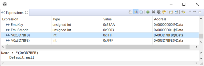

  • Chris,
    I cannot modifying the EMU values from the CCS memory browser or expressions when debugging. It sounds like these emulation psuedo registers cannot be changed in CCS memory browser or expressions when debugging? If it is true, how can I change these EMU values?
    Hao
  • Hao
    Interesting. They can definitely be configured via the CCS memory browser.
    Likely an issue in the GEL file.

  • Chris,
    When I use GetMode, I need also change the values of OTP like OTP KEY. But I cannot modify these OTP values. I try to do it in GEL file but not working. Can you let me know how I can change these OTP values?
    Thank you,
    Hao

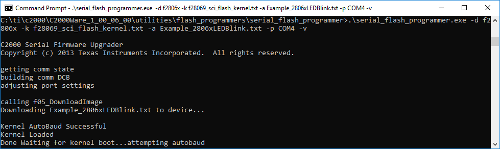

  • Chris,
    I set up the switch S1 on f28069 Launchpad to 111 (GPIO37 GPIO34 TRSTn) to EMU Mode. Then I followed steps as you mentioned as above. But The same bootloader couldn't finish to run. It stopped on "Done Waiting for kernel boot...attempting autobaud" as below.
    I don't know what causes it stop and how I can solve it? Should I change the call of Uint32 SCI_Boot() in the application?
    I have a more question: Is there any way to program and change the values of OTP key and OTP BMode?
    Hao
  • Hao
    Make sure the kernel is setup to use the same SCI GPIOs that you're using for the bootloader.
    The OTP key and BMODE are one time programmable, you can only program them once. You can program the OTP via the CCS flash utility (Tools -> On-chip flash).
    Best regards

  • Chris,
    I didn't change anything including the kernel's setting of SCI GPIOs. I used all the same command and the stream files for kernel and application. But The same bootloader couldn't finish to run. It stopped on "Done Waiting for kernel boot...attempting autobaud". Do you think if there is anything else I need do?
    Hao
  • Hao
    If you halt and load symbols for the kernel app when you get stuck, is the app in the kernel waiting for autobaud (to then receive the LED app)?
    I've seen instances where HBAUD needs to be cleared, which current kernel doesn't do. You can add in SciaRegs.SCIHBAUD = 0 in the kernel.
