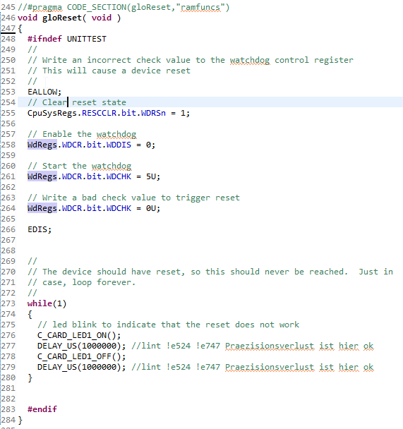

For the TMS320F28004x there is no Software reset available and a recommended solution would be using the Watchdog for generating it.
Without having the emulator connected, I run the software and make it call my reset function as below.
The Reset does not look to work since I get to the instruction after the reset.
- What may prevent the function to reset the device?
When i start the SW with connected emulator and stop at the beginning of main routine the value of
WdRegs.WDCR.bit.WDDIS is already 1
afterwards the value could not be changed, it seams to be locked.
- Do you known, if there are some project settings that disable watchdog an lock it?
