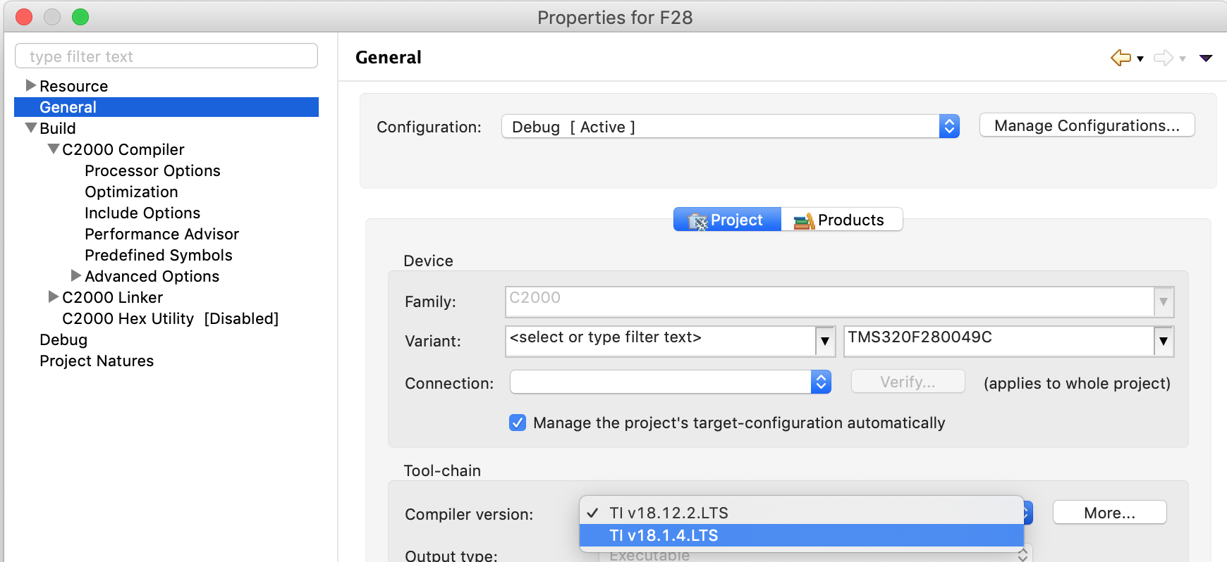

    If you don't need to use the 64bit machine anymore and are just going to running off your laptop then I would install CCSv8.3.1 on your 32bit laptop and change the project properties so that it uses the 18.1.x compiler that ships with that version of CCS.
    You can change the version of the compiler used by a project here:
    John
