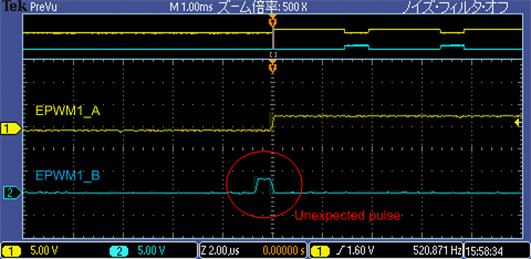

I have a question about EPWM for F280049.
This PWM setting is based on the following sample program “Active high complementary PWMs” provided by TI.
...\ti\c2000\C2000Ware_2_00_00_02\device_support\f2805x\examples\c28\epwm_deadband\Example_2805xEPwmDeadBand.c
void InitEPwm3Example()
When TBCTR = 0, this PWM setting has been changed so that EPWMxA output becomes HIGH.
An unexpected pulse is generated at startup as shown below.
Please tell me the cause and countermeasure.
The programs that cause this problem are listed below.
The change code is shown in red.
    The example mentioned above is for F2805x? Which device is being used ?
    Vasudha
  • Hi Vasudha,
    Thanks for your comment.
    I use F280049.
    I considered a new setting for F280049.
    However, "unexpected pulse" occurred.
    Therefore, I searched the sample code of F280049 “Active High Complementary PWM”, but I cannot find it.
    On the other hand, I found a sample code for f2805x in the c2000 folder.
    So I tried using the f2805x sample code, but it also produced an "unexpected pulse".
    Thanks & Regards
    User_BAN
    Is it happening once at the start when you are starting the PWM operations or regularly?
    Vasudha
  • Hi Vasudha,
    It is happening once at the start when you are starting the PWM operations.
    I think that occurs when the following code is executed.
    CpuSysRegs.PCLKCR0.bit.TBCLKSYNC = 1;
    Thanks & Regards
    User_BAN
  • Hi BAN,
    This observation is because you are configuring the DBCTL register for DB_ACTV_HIC (which is active high complimentary).
    Before the configuration of DBCTL, both PWMA & PWMB are '0'. As soon as the configuration happens, immediately the PWMB becomes the inverted version of PWMA.
    On TBCLKSYNC=1, the TBCOUNTER starts incrementing and when CMPA == TBCNT, PWMA goes '1' and since PWMB = !PWMA, PWMB goes '0' on CMPAEQ.
    If the expectation is that the PWMB should be high for larger duration (of the order of the PWMA == 1), you can add required NOPs after the DBCTL configuration before writing to TBCLKSYNC=1 .
    Hope this helps.
    Thanks and Regards,
    Akshaya
  • Hi Akshaya,
    I do not expect to increase the "unexpected pulse" duration.
    I expect to reduce the "unexpected pulse" duration.
    If possible, I want to eliminate the "unexpected pulses".
    Is there any way to erase this "unexpected pulse" when configuring the DBCTL register for DB_ACTV_HIC?
    Thanks & Regards,
    User_BAN
    The initial toggle that is visible is there because of the configuration change.
    The pulse width also depends on the CMPA value which decides the change of PWM-A.
    So, you can only align it by-
    1. Bringing the DBCTL configuration closer to PWM-A change
    2. Also, you can use the shadow to active reload for the DBCTL register and align the reload with the change in the EPWM-A output.
    The other way is - you use the PWM outputs only after you enable the PWM operation is enabled (with TBCLKSYNC write) and in that case any changes PWM outputs prior TBCLKSYNC==1 are don't care.
    Rgds,
    Akshaya

  • Hi Ban,
    There are 2 solutions that you can try -
    Solution 1 -
    Since you are setting the PWMA on ZRO ( as per EPwm3Regs.AQCTLA.bit.ZRO = AQ_SET;),  configure the DBCTL-POLSEL after TBCLKSYNC (as below) -
    EALLOW;
        EPwm3Regs.DBCTL.bit.POLSEL = DB_ACTV_HIC;
    This should eliminate the initial glitch that you are seeing in your case.
    However, please note that, this will work provided that you are keeping the AQCTLA.bit.ZRO == AQ_SET.
    Solution 2 -
     You can stop using the HIC mode. Since, you are configuring both AQCTLA & AQCTLB, you can use the below configurations (Highlighting the changes to your code in BLUE) -
        // Set actions
        EPwm3Regs.AQCTLA.bit.ZRO = AQ_SET;              // Set PWM3A on Zero
        EPwm3Regs.AQCTLA.bit.CAD = AQ_CLEAR;
        EPwm3Regs.AQCTLB.bit.ZRO = AQ_CLEAR;            // Set PWM3A on Zero
        EPwm3Regs.AQCTLB.bit.CAD = AQ_SET;
        // Active high complementary PWMs - Setup the deadband
        EPwm3Regs.DBCTL.bit.OUT_MODE = DB_FULL_ENABLE;
        EPwm3Regs.DBCTL.bit.POLSEL = DB_ACTV_HI;
        EPwm3Regs.DBCTL.bit.IN_MODE = DBA_RED_DBB_FED; //Use it as per your delay requirements
        EPwm3Regs.DBRED.all = EPWM3_MIN_DB;
        EPwm3Regs.DBFED.all = EPWM3_MIN_DB;
    Try these and let me know if this helps.
