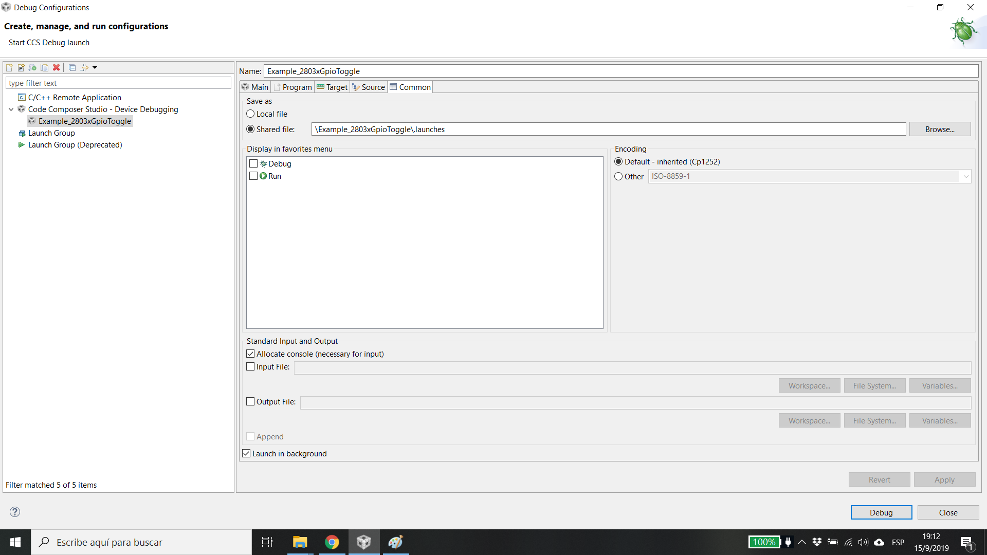

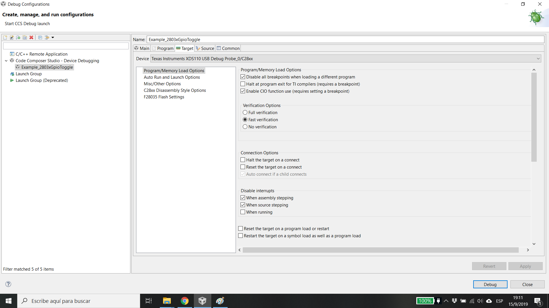

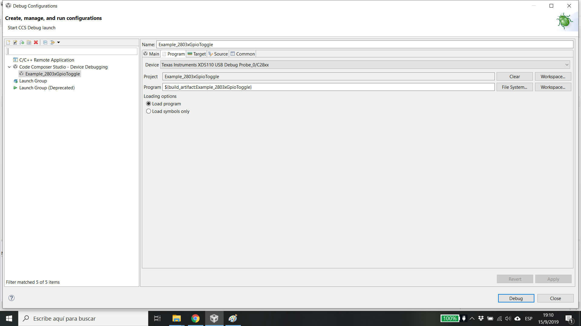

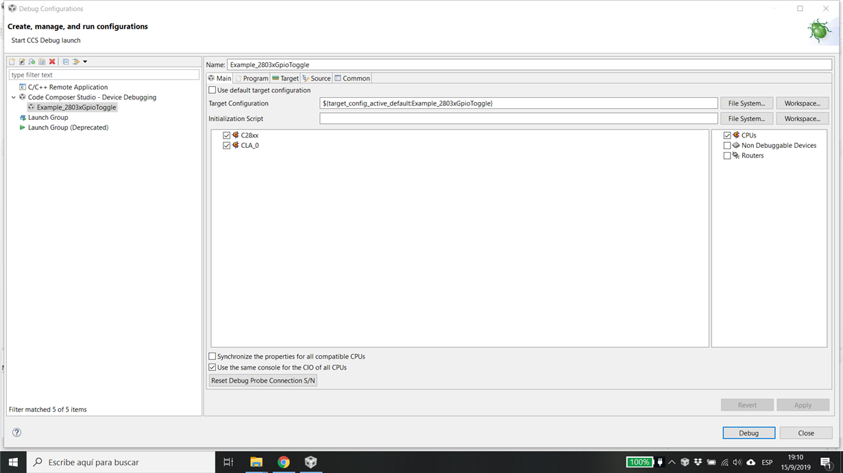

I was programming very well, and now the following error is appearing. Can anybody help me? Thank you !
I already reinstalled the program, and tried the examples
This is my configuration

Are you using a custom board? Where you able to successfully load and run your code before?
Please take a look at the following guide: http://www.ti.com/lit/an/spracf0/spracf0.pdf
It would also be helpful to search (-1135) in the following page for further debug: http://software-dl.ti.com/ccs/esd/documents/ccsv7_debugging_jtag_connectivity_issues.html
