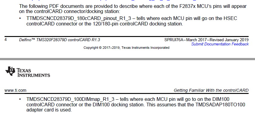

I have been trying to get exact dimensions and exact interconnecting pad locations of the Delfino control card.
In the document, there is a circular self-reference: i.e., one can read
The following PDF documents are provided to describe where each of the F2837x MCU’s pins will appear
on the controlCARD connector/docking station:
• TTMDSCNCD28379D_180cCARD_pinout_R1_3 – tells where each MCU pin will go on the HSEC
controlCARD connector or the 120/180-pin controlCARD docking station.
But if you click on the referenced link, or find the document,  it brings you back to this document!
So where can I find documents to study the interconnect pins, pinouts on the control card including its geometry? Our immediate intention is to hook it to  our demo hardware & start demo/edit modify code etc.
Also, it is gaining time: by the time we get the control card/ baseboard, signal injector, we would have made progress about interconnecting them.A related matter is : should we get the Launch pad as well with the docking card/control card& the injection card?
Appreciate pointing out where the information can be found..

  • Robin,
    you have a lot of questions in this post, so my answer might get a bit messy.
    The gerbers are provided in C2000Ware, these should provide all spatial dimensions. Additionally the following post provides some information(the first and last pins are 21mm OC) : https://e2e.ti.com/support/microcontrollers/c2000/f/171/p/530337/2074532#2074532
    I do not see any links to this document.
    The aforementioned document has a small typographical error, it should be "TMDSCNCD28377D_180cCARD_pinout_R1_3.pdf". I have submitted a bug for this to be updated.
    Finally the document named "TMDSCNCD28377D_180cCARD_pinout_R1_3.pdf" is not a circular reference and can be found in C2000Ware: C:\ti\c2000\C2000Ware_x_xx_xx_xx\boards\controlCARDs\TMDSCNCD28379D\R1_3.
