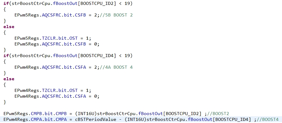

  • Sub,
    We tried again with AQCSFRC like:
    The issue is still there, without any improvement.
    What could be the issue?
    Thanks a lot.
    Br, Jordan
  • Sub,
    Let me clarify the issue in details: the issue occures only when the force is used, and occures only one time, the pulse is between 10ns~200ns.
    1) strBoostCtrCpu.fBoostOut[BoostCPU_ID2] is a globla variables. Its value will be passed to CMPA or CMPB;
    2) When the value is lower than 19, they'd like to force the output on PWMA and PWMB;
    3) CMPA and CMPB are shadowed, load on zero and period;
    4) Global reload is not used;
    5) The PWM configuration is as below: RLDCSF with value 2 or 3, the issue is the same.
    Thanks a lot.
    Br, Jordan
    What is the current state of the PWM when the output is being forced high using AQCSFRC?
    In immediate mode, a continuous force takes effect on the next TBCLK edge. In shadow mode, a continuous force takes effect on the next TBCLK edge after a shadow load into the active register.
    So I suggest you use RLDCSF=3 for immediate mode.
    Once the continuous force takes effect and PWM reaches a desired state - Only Trip logic can change the status of the PWM o/p.
    For your testing, you can disable the trip and check if there is any issue in the trip configuration that is causing this behavior.
    Did you get a chance to try above? If so, please update your observation or close this thread.
