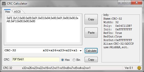

  • Hi Sira,
    I do the experiment on F2837x VCU2.
    I just disable CRCMSGFLIP bit, and manually flip input data .
    But the result (CRC32_result02) is not the same with use  " VSETCRCMSGFLIP / VCLRCRCMSGFLIP" instructions (CRC32_result01).
    Could you help me to point out why I can not get the same result?
    This help me implement CRC-32 reflected type on VCU0.
    unsigned int CRC_Test_01[16] = {0xFE,0x12,0x00,0x09,0x01,0x03,0x04,0x00,0x01,0x00,0x00,0xAB,0xF3,0x00,0x00,0x00};
    unsigned int CRC_Test_02[16] = {0x7F,0x48,0x00,0x90,0x80,0xC0,0x20,0x00,0x80,0x00,0x00,0xD5,0xCF,0x00,0x00,0x00};  //flip data
    final result data: CRC32_result01=0x70F15A61, CRC32_result02=0x94C49E23
    attach file: replace cpu_timers_cpu01.c  file  in TMS320F2837x  cpu_timers_cpu01 project.

    void CRC32_ADCCP_01(unsigned int *CRCResult, unsigned int  *CRCData, unsigned int   CRCLen);
    void CRC32_ADCCP_02(unsigned int *CRCResult, unsigned int  *CRCData, unsigned int   CRCLen);
    // Test data

        CRC32_ADCCP_01(&CRC_Test_01[16], &CRC_Test_01[0], 16);  //result 0x70F15A61
        CRC32_ADCCP_02(&CRC_Test_02[16], &CRC_Test_02[0], 16);  //result

    attach picture: CRC-32/ADCCP result
    best regards,
    Simen
  • Simen,
    Your approach is an interesting way of verifying the results.
    Please give me a day to dig into this and get back to you.
    Sira
