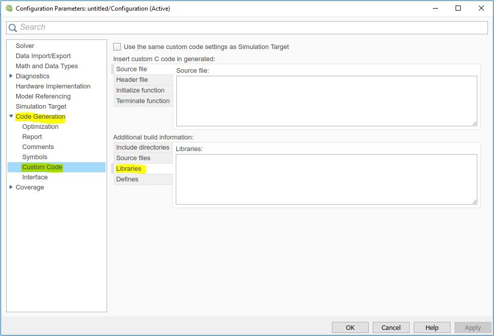

Hello all,
I am trying to configure the endat2.2 library in Simulink model which is available here:
https://de.mathworks.com/help/supportpkg/texasinstrumentsc2000/examples/permanent-magnet-synchronous-motor-field-oriented-control.html
Basically in TI, there is library made for this endat already available in ccs project: https://www.mouser.com.gt/datasheet/2/405/tidude3a-1386818.pdf
Now I want to incorporate this library into the simulink  model. Is it good Idea to include this c files in the simulink model and compile together? I am trying to include the header and source code
via C Coder block of Simulink but could not get funtion in the list. If anyone has an idea to incorporate this library of Endat in simulink, it would be great help.
Sanjaya

  • Hi Sanjaya,
    You can do this using the custom code option. Attached is the picture for the same.
    Here is a link where is the user tried to use this feature for one of his use case.
    https://www.mathworks.com/matlabcentral/answers/480196-implementation-of-functions-not-supported-by-mathworks
  • Hello Venkatesh,
    thank you for your reply. I did the same and i am able to compile. But the problem is that I need to call these functions in the main file of the after all the code is generated. When I use c caller i cannot call them. Could you please tell me how can I call these functions?

  • Hi Sanjaya,
    Please connect to us at:
    And we should be able to guide you further on this topic.
