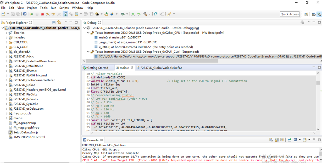

In CLA Mode when it is running this error is encounted.
CPU1_CLA1: Can't Run Target CPU: (Error -2060 @ 0x0) Requested operation cannot be done while device is running. Halt the device, and retry the operation. (Emulation package 8.2.0.00004)
How to resolve this issue?
Jingtai
  • Jingtai,
    You seem to be trying to start the CLA with the run/resume button when the CLA is idle (case 3 below):
    1. If the CLA is at an breakpoint (mdebugstop) then execution can be started using the "run/resume" button.
    2. If the CLA is halted on an instruction (ie stops at a breakpoint, and you single step instructions) then execution can be started using the run/resume button.
    3. If the CLA is idle (i.e. at a MSTOP) instruction, then it can not be started using the run/resume button.  Only a trigger (peripheral interrupt) or software force from the C28x can start the CLA.

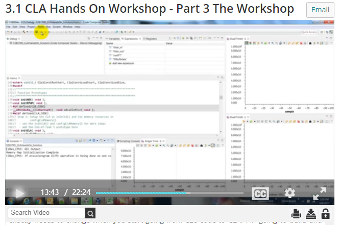

    In the video he did'nt modify the software and it seems that the software should work regularly for CLA Mode.
    How shall I do to trigger or sofware force the C28x?

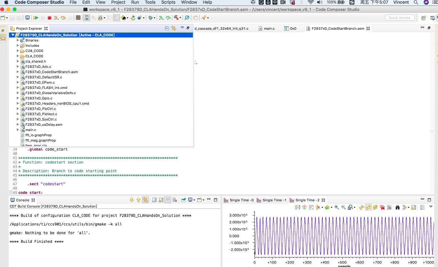

  • Lori,
    In Mac OS it works regularly.
    Regards,Jingtai

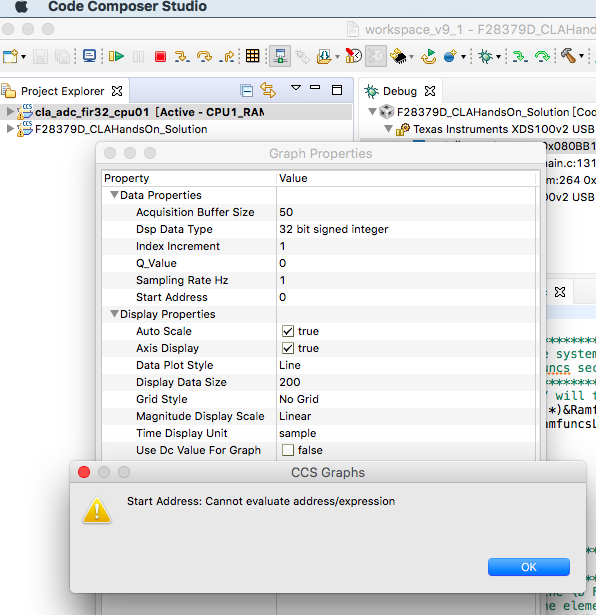

  • Lori,
    I'm going to use cla_adc_fir32_cpu1. This time the problem happens in Chinese Version Mac OS 10.13.6 when I import cla_acd_fir32graphProp.

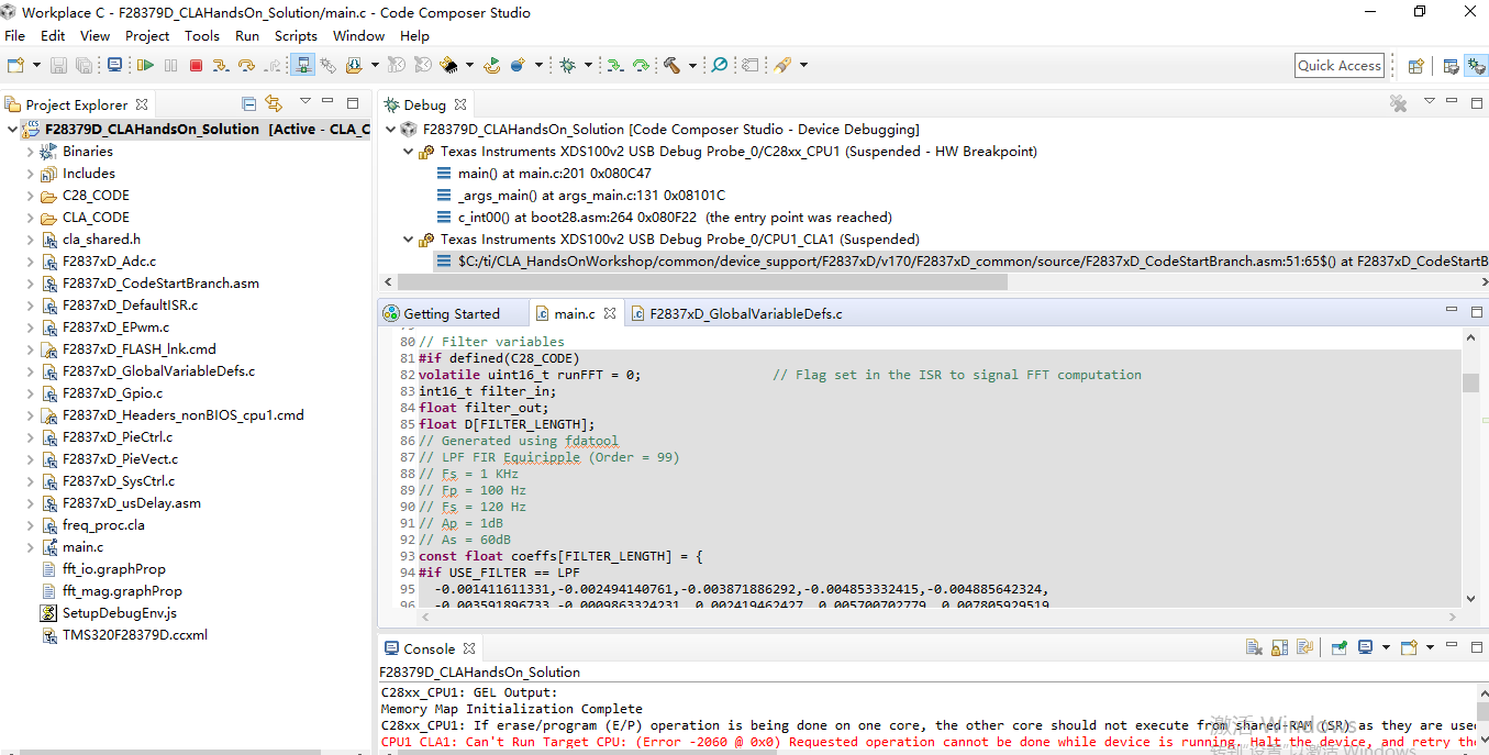

    For this particular error, I suspect you may not be following the sequence of steps outlined in the workshop. After loading the program, are you immediately connecting to the CLA and putting the CLA to run? If I do that I am also able to reproduce the error. However, the workshop tells you to run the C28x first until you halt at _mdebugstop, then run the CLA. Please clarify if you are following the same sequence of steps as outlined in the video. Hopefully that should resolve this issue.
    I'm sorry you are having these troubles but we have not been able to reproduce this issue either (on English Windows OS or MacOS). Although I can't explain why, it appears that the Chinese Windows could be a contributing factor as we have run the workshop here on multiple machines (Windows and Mac) without these issues.
