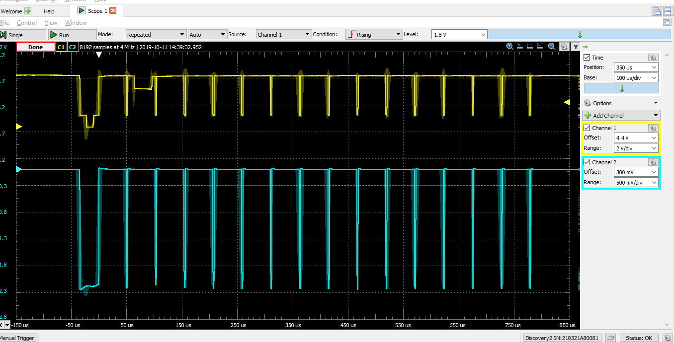

  • Hi Hareesh,
    the waveforms are like this at tx pin(gpio31)
    i am able to see the frames in canalyser while using can_ex1_loopback.
    I dont see the same while using can_ex3_external_transmit.
    BTW i looked into SPRACE5 sec 4.1. As per that i am using TMDSCNCD28004x_RevA_120cCARD_pinout.pdf for matching GPIO.
    Thank you
    Lakshmi
  • The fact that you are able to see the frames in canalyser while using can_ex1_loopback tells me that there are likely no H/W issues. For this specific testcase, are you able to see the ACK from the CANalyzer on the CANRX pin? That is the proof that the H/W path is good from start to finish. The mere appearance of frames on the analyzer cannot be construed as proof for this, since the CAN module is not really looking for an external ACK, being a self-test case. Please provide the waveform for both CANTX & CANRX pins. I would like to verify if the ACK signal is received in CANRX pin. The waveform that you capture should be exactly identical to Fig 4 in SPRACE5.
    I don’t understand what you are trying to convey with the above statement. Section 4.1 does not refer to any particular H/W. It only talks about choosing the correct GPIO pins for CAN operation based on your H/W.

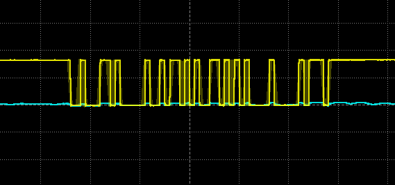

  • Hi Hareesh,
    This is the signal i am getting on GPIO 31 Tx and CAN_L vs CAN_H.
  • As clearly indicated (twice) in my previous posts, I need to see the signal on the CANRX pin, not CAN_H & CAN_L lines. Until you resolve this H/W issue at your end, I regret I cannot help further.
