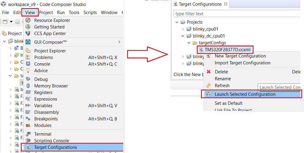

Instead of loading the program, can you just connect to CCS (launch the target configuration file and then right click on taget CPU and connect) and then open the flash address location in CCS memory watch window. Check if all the values are 0x0 or non-zero. If all the values are zero then device may have been locked. It may happen if for some reason flash operation got interrupted. Please check and let me know.

Are you telling me to start the destination configuration file, could you tell me how I do that?
What happens is that I am really new with this type of development card and I am barely familiarizing myself with the programming environment.
I thank you if you can help me
Henry,
You need to click on "View" -> Target Configuration" which will open a Target Configuration view. There you need to click on "project" and select the target configuration file (.ccxml) and right click on that and then launch it. Once launched, you need to select the CPU, right click on it and then connect.
