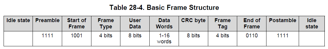

    How long it takes to transfer the FSI data out, dependent on the FSI clock speed and number of data signals being used. An FSI data frame has the structure below, which consists of 24 bits of overhead, 8 bits of User Data, up to sixteen 16-bit words, and 8 bits of CRC.
    To calculate the number of FSI clock cycles it takes to transmit a data frame of 'n' words with 'd' data lines (up to 2):
    FSI Cycles = 24 (bits of overhead) / 2 + [n * 16 (bits/word) + 8 (bits of UD) + 8 (bits CRC)] / (2 * d)
    * divide by 2 for Double Data Rate (DDR) ==> See TRM section
    Lets estimate how long it takes to transfer 4 words (16-bits each) with one data line (D0) at a 10 MHz FSI clock frequency, and using the DMA to move data into the FSI transmit buffer.
    Calculating PT:
    Will leave as PT. Can ignore if no processing needed.
    Calculating MDT:
    # of Bursts = 1
    # of words per burst = 4 (data words) + 1 (User Data) = 5
    # of DMA channels = 1 (for data) + 1 (User Data) = 2
    • User Data transfer is needed to kick off the FSI transmission automatically
    DMA SYSCLK cycles = 1 * [(3 cycles/word) * 5 + 2] = 17  SYSCLK cycles
    MDT = (DMA SYSCLK cycles) / (SYSCLK Freq) = 17 / 100 MHz = 0.17 us
    Calculating TT:
    n = 4 (words),     d = 1 (data lines)
    FSI Cycles = 24 / 2 + [4 * 16 + 8 + 8] / (2 * 1) = 52 FSI cycles
    TT = (FSI Cycles) / (FSI Freq) = 52 / 10 MHz = 5.2 us
    Total Transfer Time (4 words) = MDT + TT + (PT) = 0.17 us + 5.2 us + (PT) = 5.37 us + (PT)
    Total Transfer Time (6 words) = 7.03 us + (PT)
    Total Transfer Time (12 words) = 12.01 us + (PT)
