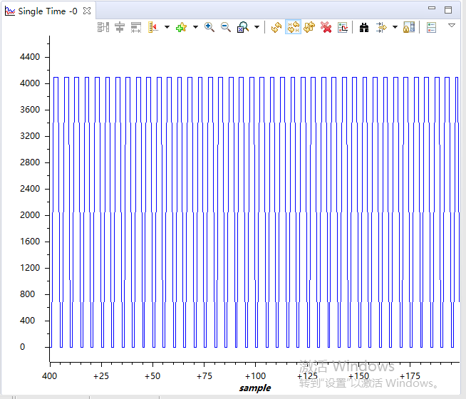

I imported the cla_adc_fir32graphProp into the cla_adc_fir32_cpu1 and get this graph.
My CCS version 9.1.0 and Chinese version Windows 10

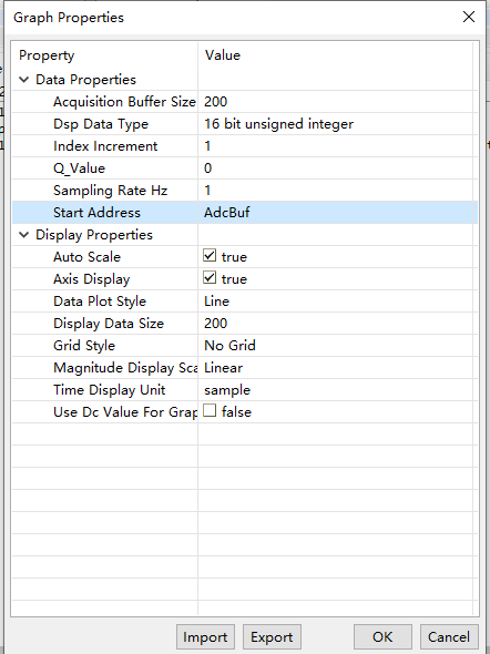

I think there is some issue with the graphProp file provided with the example. This will be fixed in the next release.

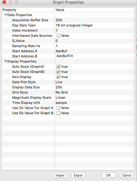

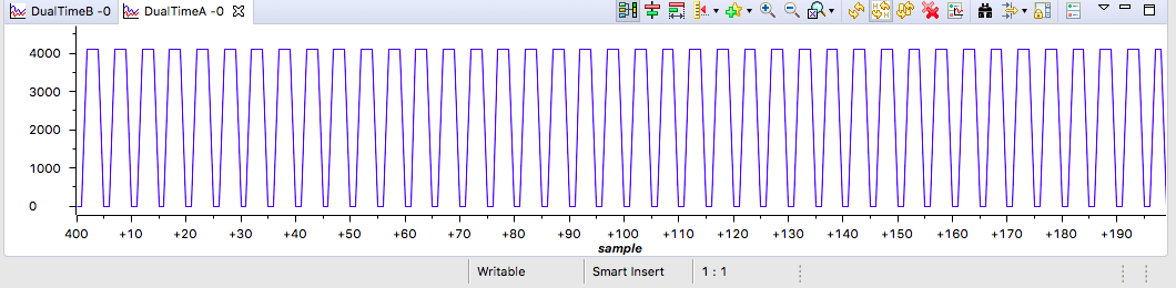

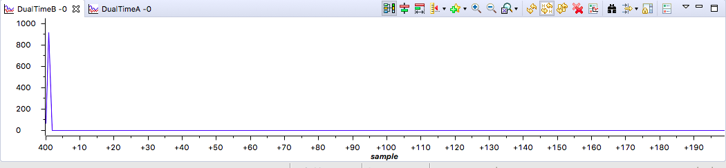

You can plot AdcBuf and AdcFiltBuf in graph to view the results.
Vasudha
You can use "Dual Time" Graph option available under Tools-> Graph-> Dual Time to add two data sources as shown above.
