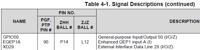

    Is XINTF operating in 32b mode?  If so, you may be having problems because GPIO50 is mux'd with XD29.
    -Tommy

     XINTF operating in 16b mode in my DSP28335 program, Please see the below code:
     //--- Zone 6 Configuration
     XintfRegs.XTIMING6.bit.X2TIMING = 0; // Timing scale factor = 1
     XintfRegs.XTIMING6.bit.XSIZE = 3; // 3 means 16-bit interface
     XintfRegs.XTIMING6.bit.READYMODE = 1;  // XREADY is asynchronous
     XintfRegs.XTIMING6.bit.USEREADY = 0; // Disable XREADY
     XintfRegs.XTIMING6.bit.XRDLEAD = 1; // Read lead time
     XintfRegs.XTIMING6.bit.XRDACTIVE = 2; // Read active time
     XintfRegs.XTIMING6.bit.XRDTRAIL = 0; // Read trail time
     XintfRegs.XTIMING6.bit.XWRLEAD = 1; // Write lead time
     XintfRegs.XTIMING6.bit.XWRACTIVE = 2; // Write active time
     XintfRegs.XTIMING6.bit.XWRTRAIL = 0; // Write trail time
