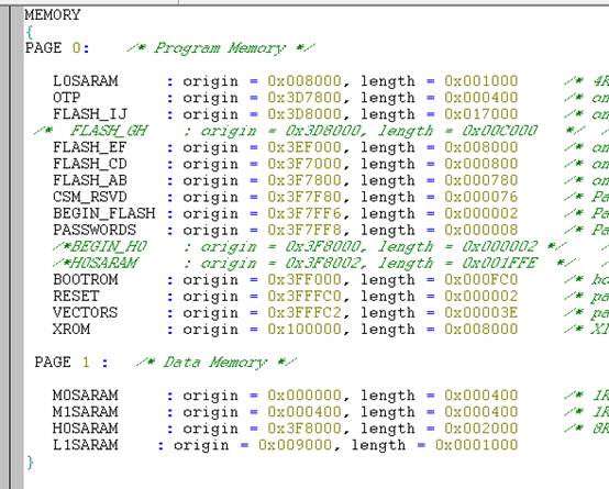

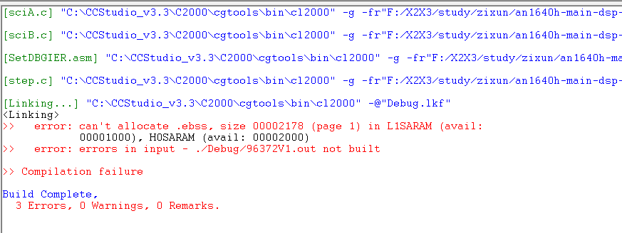

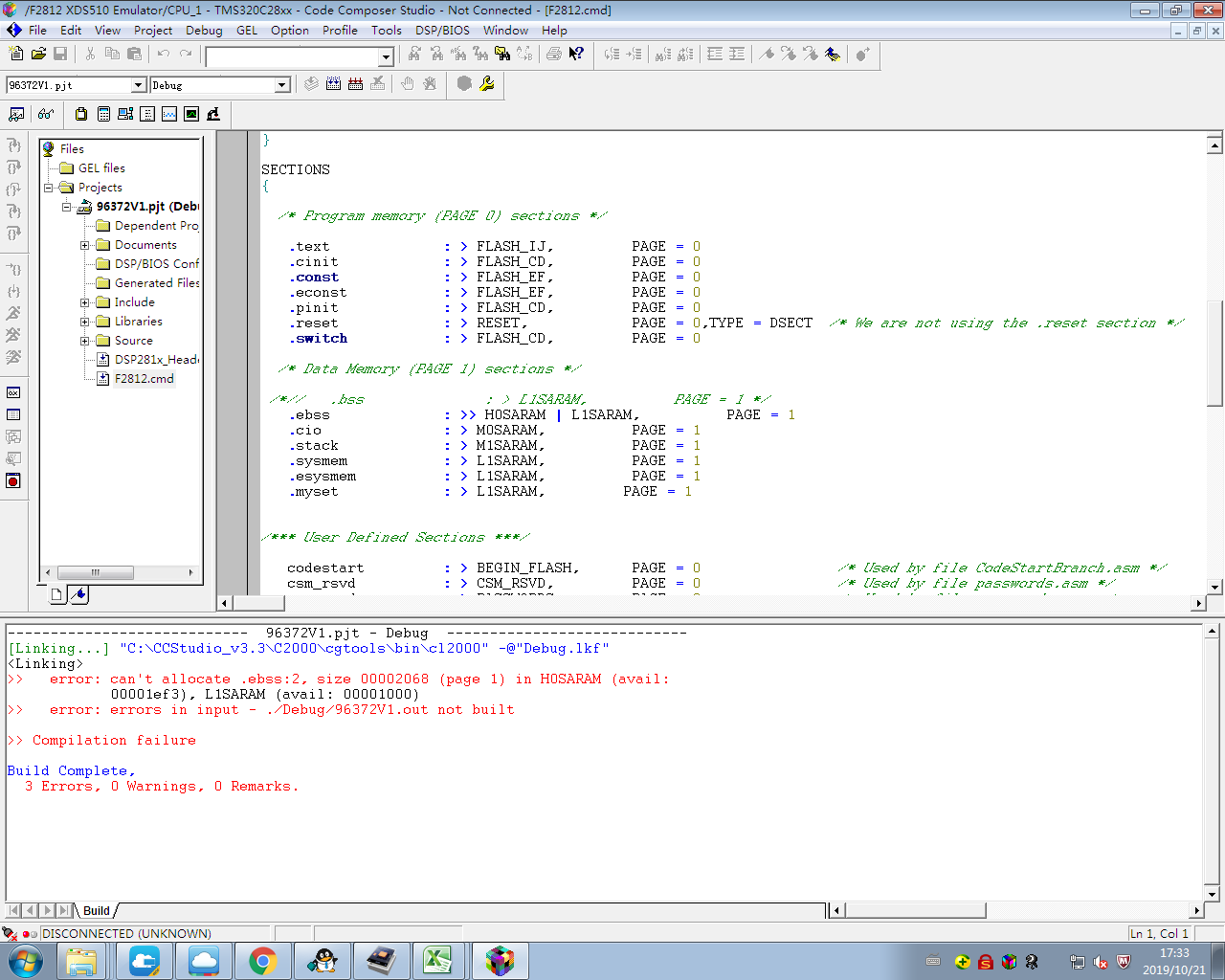

1.  When the customer was at DSP2812, the customer was prompted that the RAM area was out of memory. Looking at the. Map file, I found that H0SARAM is used, while L1SARAM is not, but I don't know how to use it.

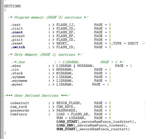

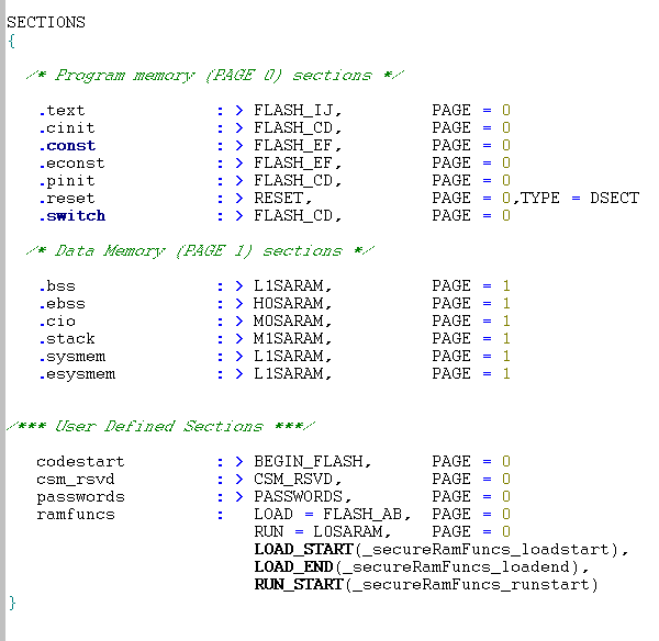

.cmd file:
2. Is there any difference between .bss and .ebss? It is said that. BSS can only be used for 64k addresses. Ebss is used when using mass storage. Does it mean that the address of H0SARAM above is 3F800? This can only be defined by.ebss, not .bss, right?
