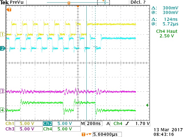

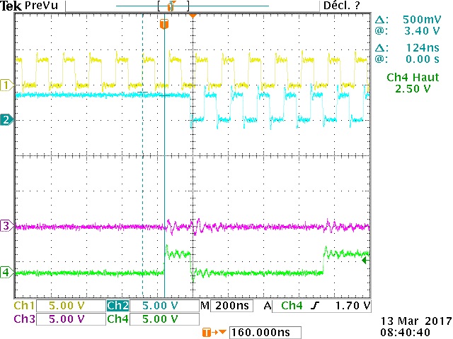

Then, I read the SPI signal.
CH1 Yellow: GPIO 6 EnDat Sensor Clock
CH2: Blue: GPIO 7 SPI Slave Clock
CH3: GPIO 34 ENDAT_DIR
CH4: Green: SPISIMO = ENDAT_DIN
I read the SPI config register, POLARITY = 1, and CLKPHASE = 0. Then this means "Falling edge without delay" So input data are sampled on SPI Clk rising edge, when  EnDatSensor update data on th rising edge of its clock.
But according the scope, the rising edge of SPI is near to the rising edge of the Sensor.. I think SPI input some time bad sample because Rising edge come to fast?
Receive SPI Data for the scope above is : 0x0031, 0x872C, 0xA497. Some word are Ok, but some are bad where on SPI Data, I thing read: 0x0031 A69C 1D24
Calculated compensation delay (even if CRC bad) is 13.
SPI clock always let to 200KHz (not change to 8MHz... but same problem at 8MHz)
sensor is Heidenhain EQI1331
Thank
    Great to hear that you've the BiSS-C interface working. Thanks for the detailed diagrams.
    I'm wondering why the received CRC is always a fixed number - is the encoder response a valid response or an error response?
    Also,
    As you would have noted the SPI CLK and the encoder clock will be operating in different phases to capture the data correctly (for delay compensation).
    For some reason the phase alignment doesn't seem to be correct from the wave forms.
    Could manually change the POLARITY and CLKPHASE values see if the data value is captured properly?
    You could also try to change the delay_comp value, but that doesn't seem to be the problem as you are seeing fail at low frequency, even without delay compensation.

    I'm using a 2m câble.
    I try with a clock of 8.33MHZ (ENDAT_RUNTIME_FREQ_DIVIDER= 6), the phase seems better. This means at low frequency, tere are a problem in computation of the phase delay?
    But with ENDAT_RUNTIME_FREQ_DIVIDER = 6, the last clock pulse is shorter!... this is strange..
    So I set ENDAT_RUNTIME_FREQ_DIVIDER to 7. (= 7.14MHz)
    Clock phase seems Ok.
    The measure delay by the library is 13 (= 130ns?). If I understood, this delay is measure between the Rising Edge of the clock and the Bit Start rising edge. With the scope, I measured 124ns. (Screenshot)
    Note this delay correspond aproximately to my Frequency (T = 140ns). THis is why the scope could be confused because we must keep in mind the 130ns delay between the Endat Clock and the received data.
    This is why into the screenshot, we can see a pulse of the SPI clock about 1 period later than the last pulse of the clock Endat.
    I try to set the delay_compens to 0 instead of 13 (before call PM_endat22_setFreq because it seem the delay_compens is only taken with the call of PM_endat22_setFreq function. I'm right?) but 0 instead of 13 provide exacltly the same graph... Why??...

    Zoom on the start bit and the delay (124ns)
    Zoom on the last Endat clock, where the line should be set to 1 after the propagation delay time..  but pass to 0!...
    Then I don't know how make work properly. I'm lose to know how resolve the problem?...where is my problem?
