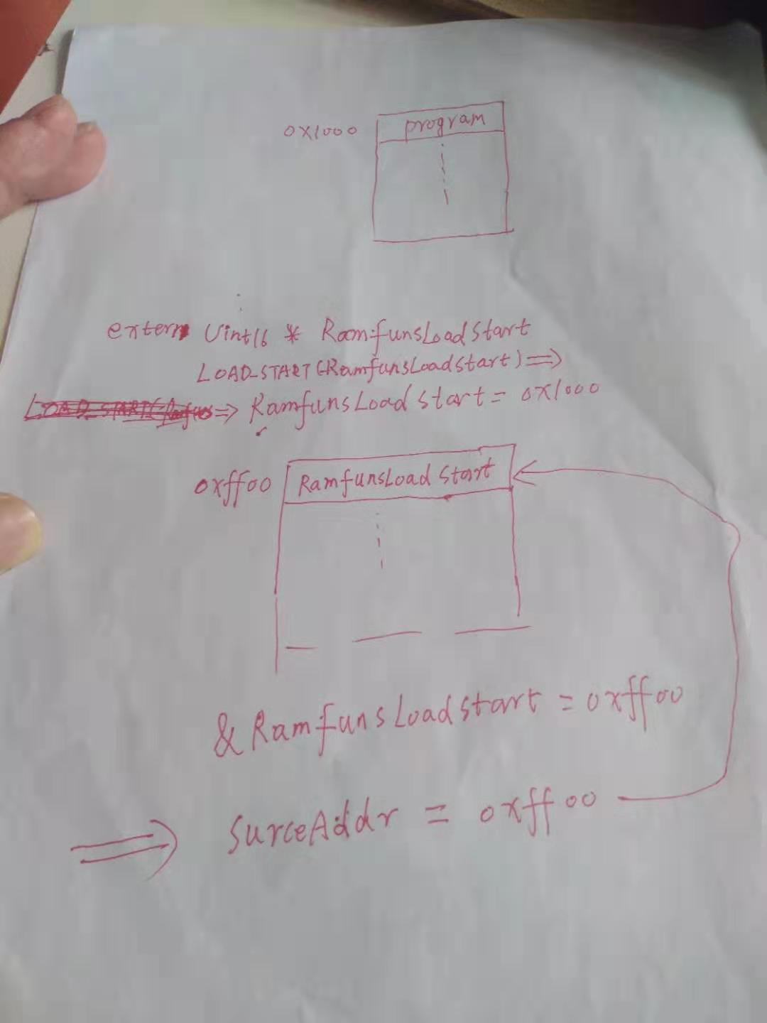

CCS/TMS320F28035: 'MemCopy(&RamfuncsLoadStart, &RamfuncsLoadEnd, &RamfuncsRunStart)' is right ?
Part Number: TMS320F28035
SECTIONS
   /* Allocate program areas: */
   .cinit            : > FLASHA,     PAGE = 0
   .pinit            : > FLASHA,     PAGE = 0
   .text             : > FLASHA,     PAGE = 0
   codestart         : > BEGIN       PAGE = 0
   ramfuncs          : LOAD = FLASHD,
                       RUN = progRAM,
                       LOAD_START(_RamfuncsLoadStart),
                       LOAD_END(_RamfuncsLoadEnd),
                       RUN_START(_RamfuncsRunStart),
                       PAGE = 0
void MemCopy(Uint16 *SourceAddr, Uint16* SourceEndAddr, Uint16* DestAddr)
    while(SourceAddr < SourceEndAddr)
       *DestAddr++ = *SourceAddr++;
    return;
extern Uint16 *RamfuncsLoadStart, *RamfuncsLoadEnd, *RamfuncsRunStart;
MemCopy(&RamfuncsLoadStart, &RamfuncsLoadEnd, &RamfuncsRunStart);
       For the above program, I think it is correct to change from ‘MemCopy(&RamfuncsLoadStart, &RamfuncsLoadEnd, &RamfuncsRunStart)’ to ’MemCopy(RamfuncsLoadStart, RamfuncsLoadEnd, RamfuncsRunStart)‘.
      For example, RamfuncsLoadStart points to the program's first address 0x1000,  the address of RamfuncsLoadStart itself is 0xff00, and &RamfuncsLoadStart takes the address 0xff00 instead of 0x1000. This obviously does not copy the program from flash to ram.
